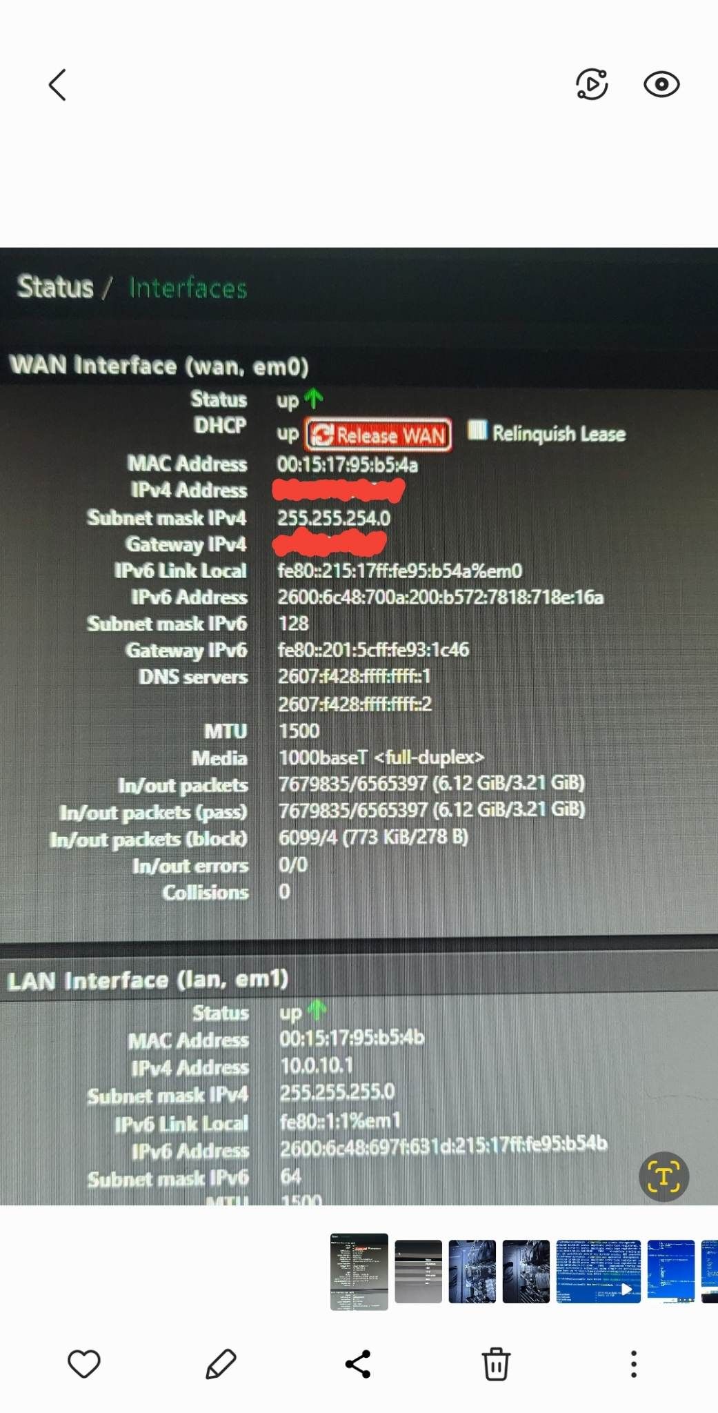

                        • L Offline
                          lawrence1986 @stephenw10
                            The WAN disconnects appear to have nothing to do with accessing the rockstargames sign-in page. Unless you are saying that is logged everytime you try to connect?
                            I see your LAN IP is the expected 10.0.10.1 though so that's good. The AP really is running as an AP.
