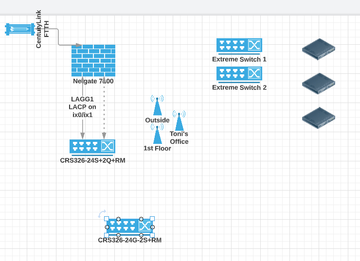

                  Here's an incomplete one of my own network:
