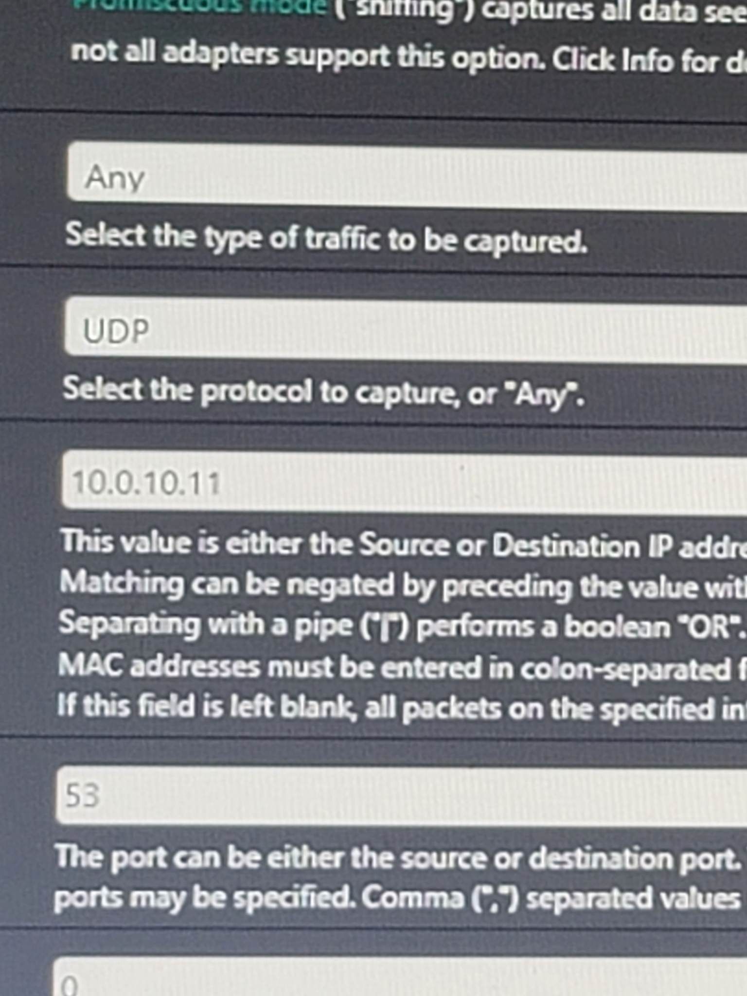

            rcoleman-netgate Netgate @lawrence1986
            @lawrence1986 Ok so the DNS call is looked up and found via NSLOOKUP but your computer appears to be ignoring that.
            ipconfig /all
            And just the output for your primary connection on this computer (ETH or WiFi, whichever).
            Also you can do a packet capture on the pfSense (Diagnostics->Packet Capture) on your interface filtered to just your test PC's IP address and you can further filter to UDP port 53 (to limit only to DNS requests) and see where it is going -- if the request ever gets to the pfSense interface).

                                      • L
                                        lawrence1986 @lawrence1986
                                        @lawrence1986 It gave me a big, fat goose egg. I'm just going to snapshot some photos here so that way you can tell me if I'm doing it right.!316605443_586442046698371_4844380842064925714_n.jpg 316435751_1386745932130785_7527994808949536153_n.jpg
                                        • R

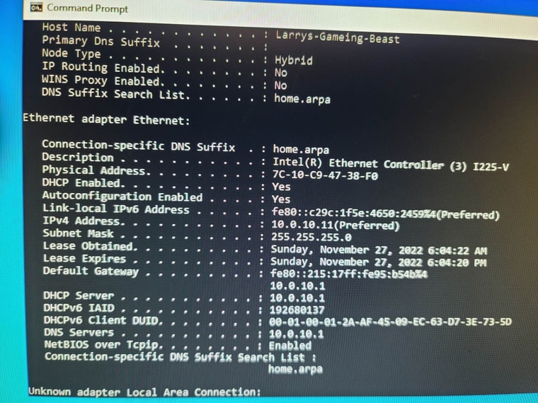

                                          @lawrence1986 So, as I noted, that means your requests aren't even going to pfSense.
                                          But I asked you to run
                                          ipconfig /all
                                          and show us what your computer's settings are set to. If you're not calling pfSense for DNS (you could have it configured for that but your browser is using DNS over HTTPS or DoH) and that will not show up on UDP53.
                                          Again I will comment that your photos are WAY BIG and hard to read. Please consider using Snipping Tool or another screen cap program instead of a cell phone camera.

                                          • L
                                            lawrence1986 @rcoleman-netgate
                                            @rcoleman-netgate i forgot! shit ok 1 min 316687667_683499393338372_1558142724151121517_n.jpg
