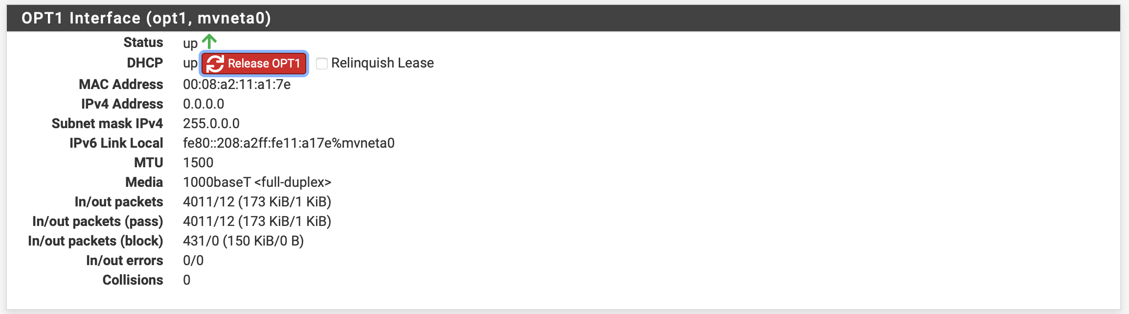

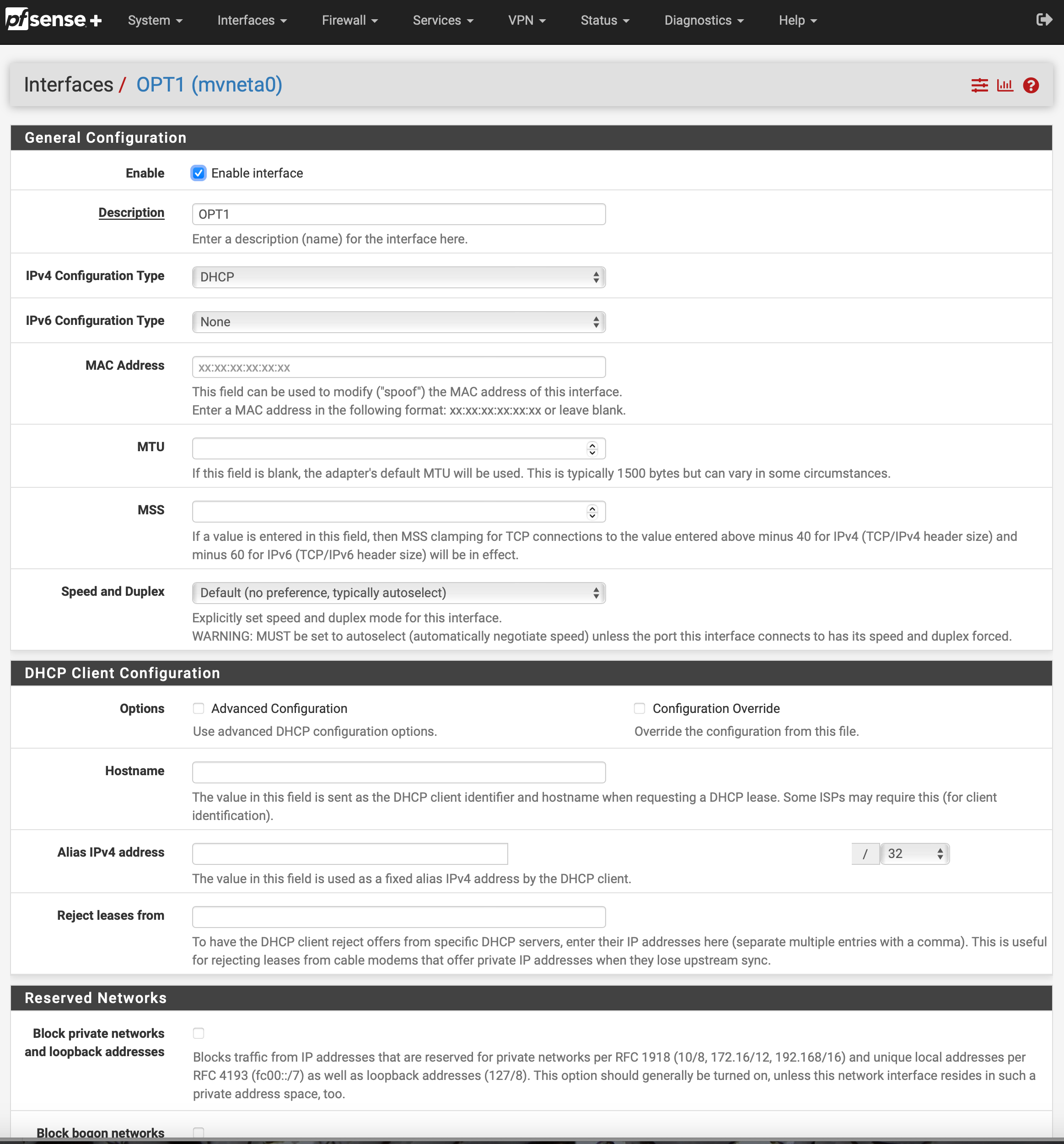

      I have a NG 3100 and just got Optimum Fiber installed. I have one Internet connection to the WAN port and was going to use the OPT port as a WAN2 port.
      For some reason, I cannot get an IPv4 address from the ISP. When I connect my laptop to the ISP's modem I get an IPv4 lease. When I connect the OPT port to the modem, it cannot get a lease.
      Powercycled everything and still no luck.

        I just tried reconfiguring the WAN port for DHCP and seeing if that worked. It did not.
        It seems that the WAN and OPT ports on my Netgate 3100 cannot pull a WAN DHCP address from Optimum's DHCP servers. Works fine on my MacBook Pro. And the WAN port has a static IP address to a coax modem, and that works fine.
