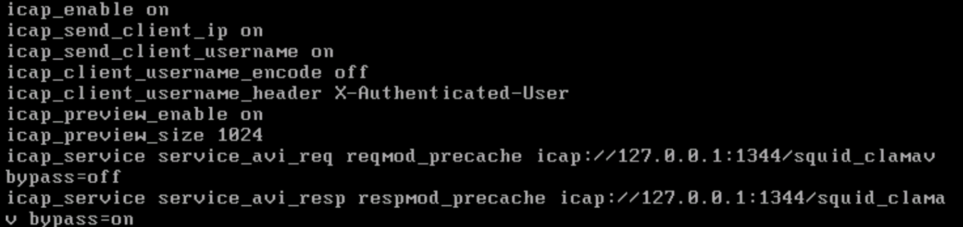

In the squid web UI, I have enabled Squid Antivirus check using clamav, and in the squid.conf I can see that icap is enabled:

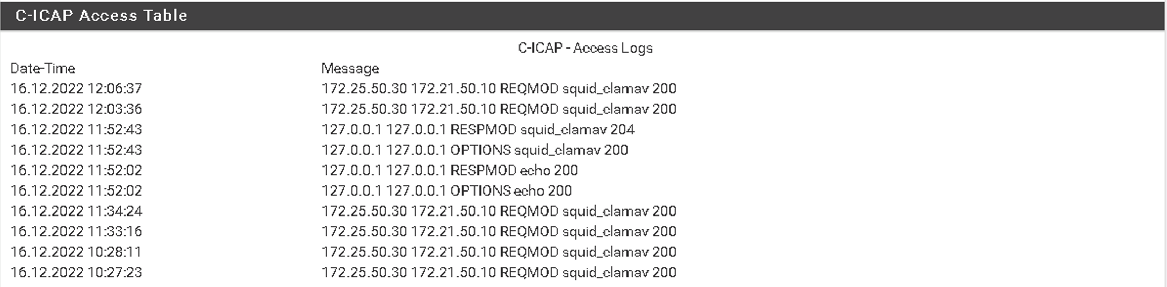

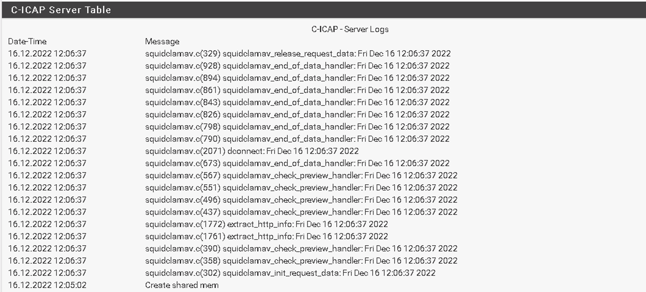

In the c-icap.conf I've setup debuglevel : 3 and in the logs I only get things like the following :
I have tried many different configs and solutions that I found in the forums here, however, nothing I do will produce the eicar test file being flagged as a virus and I can upload that file without it being blocked.
