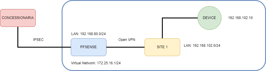

      I'm using PFsense and i have this situation:
      I have a PFsense already connected with "Site1" through OpenVPN. I can acess the "Device" normally in Pfsense network. I can make chances only in PFSense.
      But now i have to make another VPN with "Concessionaria" but this network ask-me address in another range (172.25.16.0/24). Basically, the "Concessionaria" wants access "Device" through Pfsense using the address 172.25.16.5 (so, it's a virtual IP).
      What i try:
      In PFSense -> Firewal -> Virtual IPs -> Add IP Alias
      Interface: LAN Address / 172.25.16.1/24
      Then i could make a IPSEC Túnnel using this address network in Phase2 with "Concessinaria". They can ping 172.25.16.1 normally.
      So, i create a NAT 1:1 with these settings:
      Interface:WAN
      External Subnet IP: 172.25.16.5 (virtual address of "Device")
      Internal IP: Any
      Destination: 192.168.102.10
      NAT Reflection: Enable
      But the concessionária could not ping this IP. Missing some small detail ....

        Don't configure NAT 1:1 for IPSec connections! IPSec provides its own NAT in the phase 2, which you should use here.
          Yup, you can't apply NAT to policy based IPSec like that. And that rule on the WAN anyway so can never match.
          You need to configure NAT in the phase 2 as @viragomann said.
          https://docs.netgate.com/pfsense/en/latest/vpn/ipsec/phase-2-nat.html
          If they only need to access that one IP then you might be able to use a P2 with only that single IP in it. However they might not allow that and only bring up a P2 for the full 172.25.16.0/24 subnet. In that case you would need to translate 172.25.16.0:192.168.102.0 and that might be a problem because the 'device' will appear to be at 172.25.16.10 not .5.
          Additionally the router at Site 1 will need a route back to the source IP of whatever the Concessionaria is using. If you cannot add routes at Site 1 you will need to outbound NAT that across the OpenVPN tunnel so Site 1 can reply.

            @stephenw10 in my case the concessionaria wants access only 2 devices in Site1 through pfsense. Not necessary translate all network.
            So, how woluld i configure phase 2 for this case?
            And how would i make this outbond rule? Assuming for example, concessionaria network is 192.168.15.0/24?
            In Outbound -> NAT Entry, i put :
            Source: 192.168.15./24
            Destination: 172.25.16.5
            And the fileds Address and PortRange in "Translation"?
            Thanks a lot!
              Can you have 2 Phase 2 policies over the IPSec tunnel? If so you can have one for each of the hosts at Site 1. If they only allow 1 Phase 2 it must cover the full Site 1 subnet and that means the last octet in the address must be the same. So: 172.25.16.10:192.168.102.10 for example.
              In the outbound NAT rule the NAT address will be the pfSense OpenVPN address and the port will be 'any', you are not translating the ports.
              I assume you cannot add routes at Site 1 then?
              F 2 Replies Last reply Reply Quote 0
              • F Offline
                felipefonsecabh @stephenw10
                @stephenw10 yes, i can't add routes in Site1 and i could configure 2 Phase 2 policies.
                  Ah, in that case you should be able to do it exactly as they want. Just add a P2 for each device with the translation they are asking for.
                  If you can add a static route at Site 1 (probably in the OpenVPN config) to the Concessionaria subnet then you won't need an outbound NAT rule in pfSense.
                  That's a cleaner approach. the target devices will see the real source IP etc.
                    Sorry @stephenw10 , but i don't understand what IP or Network i have to put in Phase 2. The "Concessionaria" must have see devices with virtual IP (172.25.16.X) . In this case the outbound configuration above is correct?
                      The phase 2 entry for each device should use the IP address they specify in the 'NAT/BINAT translation' and the real address in the 'Local Network' field.
                      See: https://docs.netgate.com/pfsense/en/latest/vpn/ipsec/phase-2-nat.html#example
                      You do not need an outbound NAT rule if you can add the route to the OpenVPN tunnel at Site1.
