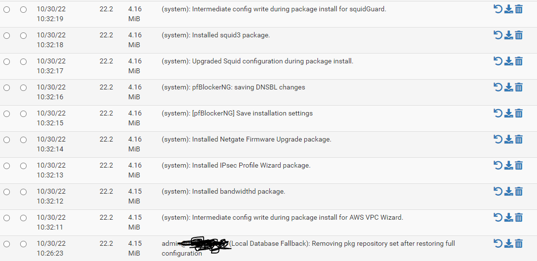

            When I compare the config history between 'Restore' and 'Download':
            -When I actually click 'Restore', It starts from 'Removing pkg repository set after restoring full configuration'.

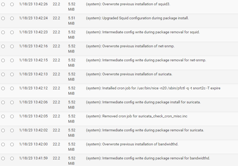

            • and the history of the issue happened:
            It started Immediate config write during package removal for ~.
            Before I click 'download config', I disabled one of rule and that's the reason why I did backup.
            Can we call this one of system crush? I disabled a rule and I clicked download before it was applying?
