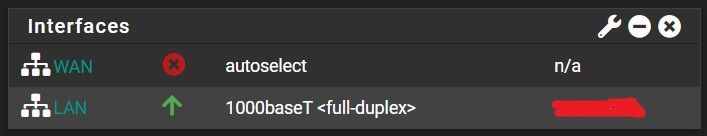

      Hello pfSense Community,
      I am running into an issue with my pfSense box whereby the WAN interface gets stuck in a loop changing it's state from UP to DOWN rapidly. A few seconds UP and Internet functions, a few second DOWN and the Internet is inaccessible, over and over and over. When this happens it will do it for hours. Restarting the box seems to have always resolved the problem.
      I have troubleshot the WAN connection and it seems the issue is related to the pfSense box itself. Swapping out to a cheap router I have during this behavior has show there is no issue with the WAN link.
      The box is running 2.6.0-RELEASE (amd64) with a very basic config. No packages installed outside of the stock base roll out.
      The computer is a Dell Optiplex 3020 with a Intel I350T4V2BLK RJ45 PCI-Express OEM 4-Port Ethernet Server Adapter Gigabit installed.
      Does anyone have any ideas? Logs attached. pf.txt Please let me know any further information that would be helpful. Happy to provide. I truly love pfSense and hopefully can resolve this minor annoyance.
