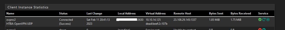

      OpenVPN reports connected and good for both server and client.

          Yes, the 1100 is the OpenVPN client.

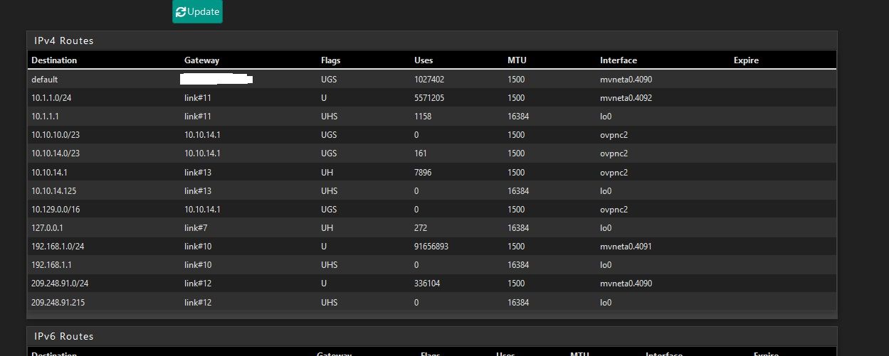

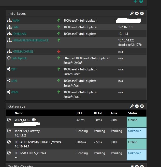

          Make a gateway for my internal LAN (interface 3 Home Lab).
          Make a static route pointing any 10.1.1.1/24 traffic to it.
          (Idea source: https://www.youtube.com/watch?v=oIN9wMC80rA)
          I am getting conflict errors and after changing a few things I still have no luck.
          Home Lab 10.1.1.1/24
          Remote Lab 10.10.14.0/23 & 10.129.0.0/16

            You will need a route at the server end to be able to open connections from there back your home lab subnet directly. Otherwise the router there has no idea where 10.1.1.0/24 is.
            If it's for specific things you can port forwards on the OpenVPN interface in the 1100 to forward traffic to targets on your home lab subnet. Then open connections to them using the OpenVPN interface address, 10.10.14.125. If that's not static it becomes more complex.
