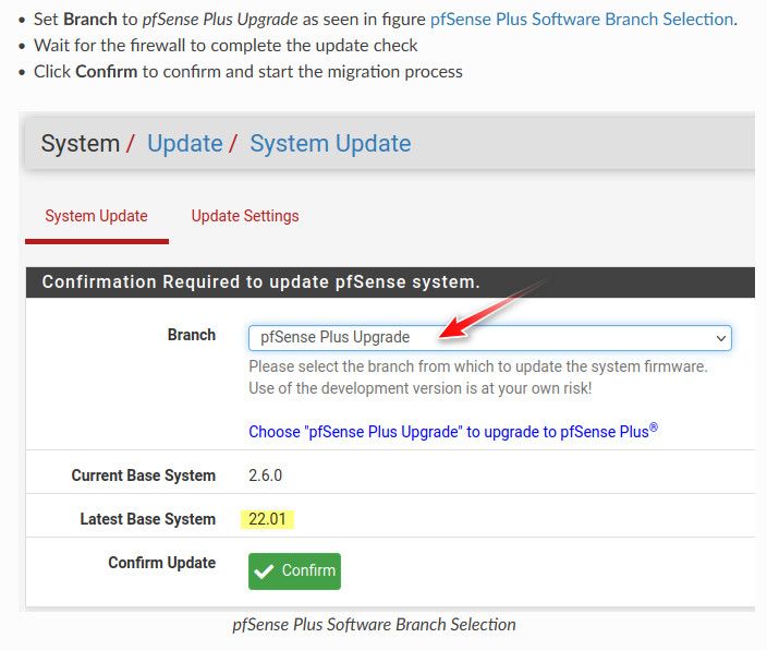

          https://docs.netgate.com/pfsense/en/latest/install/migrate-to-plus.html#migrate-from-pfsense-ce-software-to-netgate-pfsense-plus-software
          Once you have gotten your token and you select your + branch does it list say 22.05 and 23.01 ?

            Johnpoz, your graphical description helped me go to: System/Update/System Update/Branch/pfSense Plus Upgrade where I was indeed able to upgrade from pfSense 2.6.0 CE to pfSense Plus version 22.01

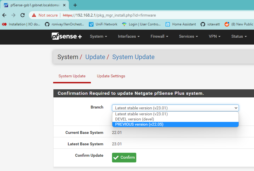

            After that upgrade completed, I was able to update to 22.05 like you suggested:
            I selected the PREVIOUS version, it was as simple as that.
            After running on 22.05 for a few minutes, I performed a restore by picking the XML file that I had made just prior to attempting to update to 23.01 three days ago.
