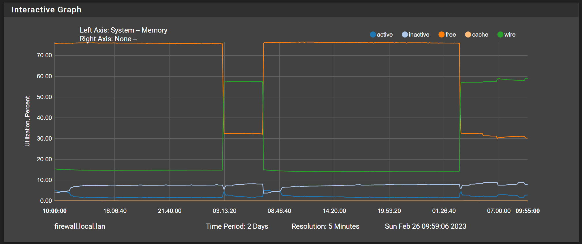

            SteveITS Galactic Empire @scottlindner
            @scottlindner ZFS ARC is a cache. It’s supposed to be released if/when needed.
            The 3am increase is from cron jobs disabled in prior versions. The patch above disables the cron job.
            https://forum.netgate.com/topic/178279/upgrade-to-23-01-3x-memory-usage/2
            Upvote 👍 helpful posts!

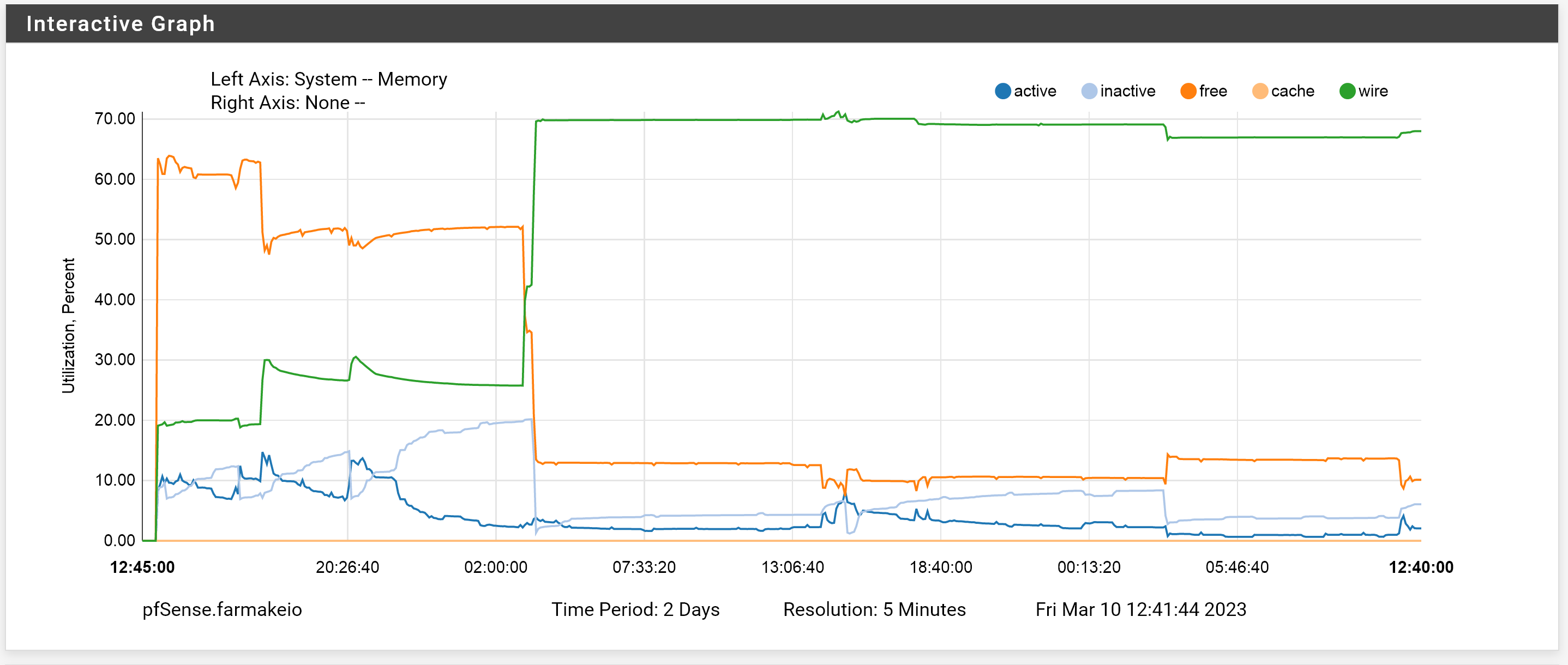

                        After applying the patch the memory usage has been very low. Slightly lower than before the upgrade to 23.01, and 22.05 (if I recall the previous version right) always had a slight memory creep of about 1%/month and this new version with the patch applied is consistently lower by a few percentage points and it stays there. Thank you everyone!
                          dimitristsilis
                          I have a similar problem. My RAM usage is ~40% after rebooting my SG1100 and it jumps to ~85% at 3:00 am. Should I apply the aforementioned patch?
                            scottlindner @dimitristsilis
                            @dimitristsilis said in Upgrade to 23.01 3x memory usage:
                            If that started after the upgrade to 23.01, then yes, the patch will fix it. The instructions are in this thread. I didn't know how to patch either. It's super easy.

                              My understanding is that this is more of a visual/perception issue than a real problem... am I understanding correctly?
                              S S 2 Replies Last reply Reply Quote 0
                                SteveITS Galactic Empire @NGUSER6947
                                @nguser6947 said in Upgrade to 23.01 3x memory usage:
                                Pretty much. See
                                https://forum.netgate.com/topic/178568/netgate-1100-high-memory-consumption/4 and the ZFS doc linked there.
                                  scottlindner @NGUSER6947
                                  No. It is real, but it is also largely harmless too. It is happening due to some default OS Cron jobs starting things pfEense doesn't need. It was an oversight. The patch turns those Cron jobs off the way the pfSense crew intended.
                                    @scottlindner said in Upgrade to 23.01 3x memory usage:
                                    The cron jobs did get enabled again, however, that's just a trigger. It's my understanding any disk activity will grow the ZFS ARC cache as noted ("1/2 RAM or the total RAM minus 1GB, whichever is greater").
                                    Whether that actually causes a problem or is just cosmetic is situation dependent. "ZFS will yield this RAM if other processes require more memory, but it may not give up memory fast enough for every use case."
                                      scottlindner @SteveITS
                                      @steveits said in Upgrade to 23.01 3x memory usage:
                                      For sure. I think it's more, "Something changed, is it bad?"
