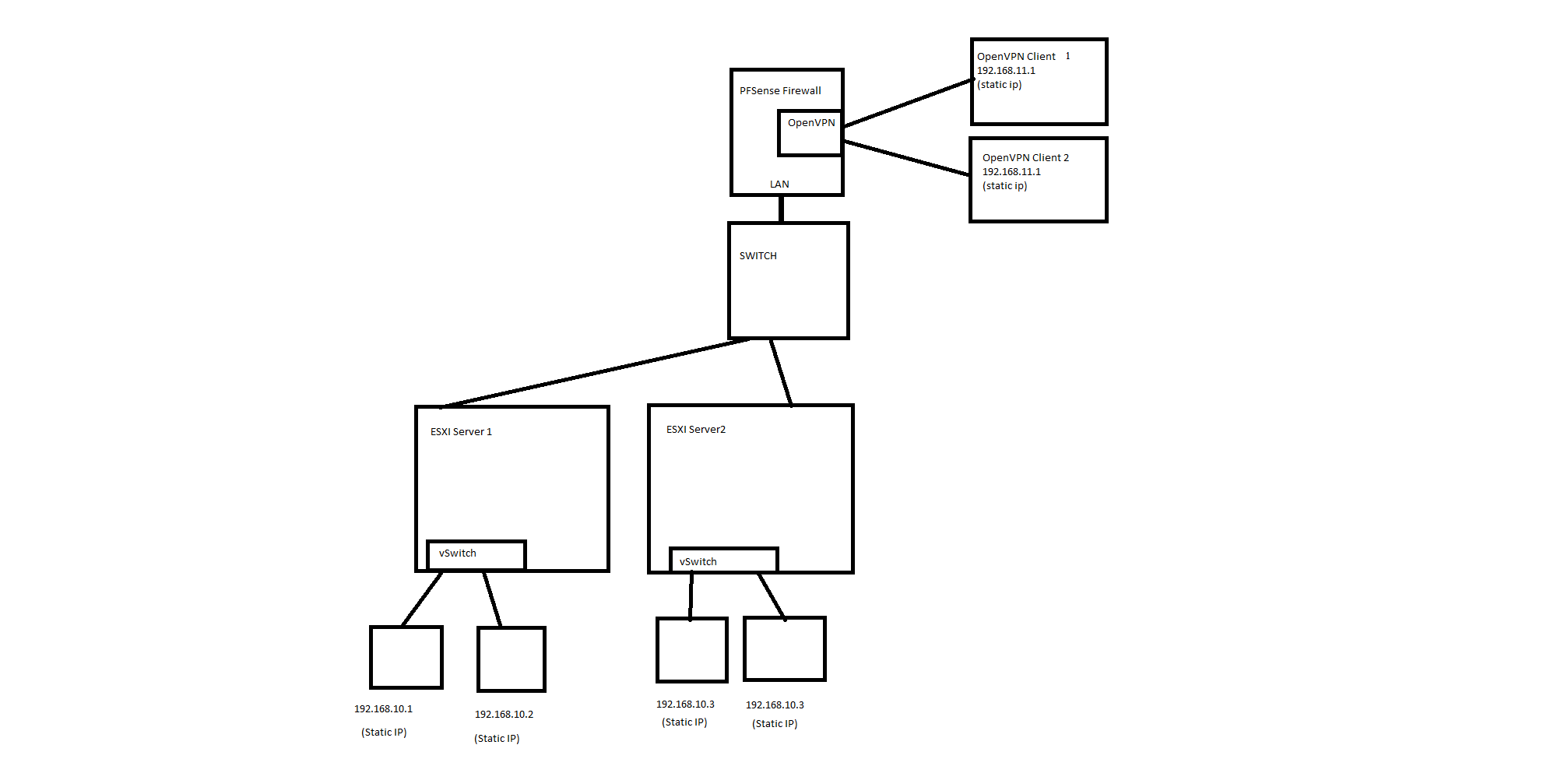

Hi, I am new to netgate and using pfsense+. Following is my network architecture:
What I am trying to achieve is to block communication between the nodes at the bottom (192.168.10.x). At the same time, I want to allow specific VPN nodes to communicate with the LAN nodes, and between the LAN nodes on a case by case basis, but basically remain blocked if not allowed.
I tried giving a firewall entry to block between two nodes, and still they can communicate. What is the best solution I can get for this case?

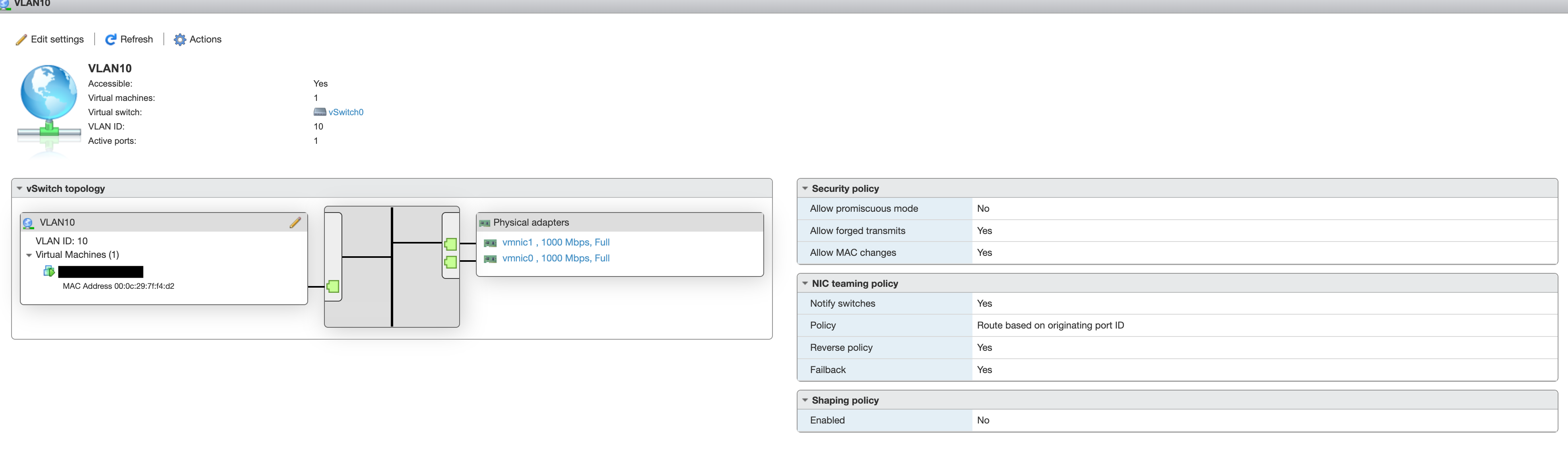

I tried everything I could, but could not get it working. I created a port group with VLAN id 10 in ESXi:Then I attached a VM's NIC to this VLAN:

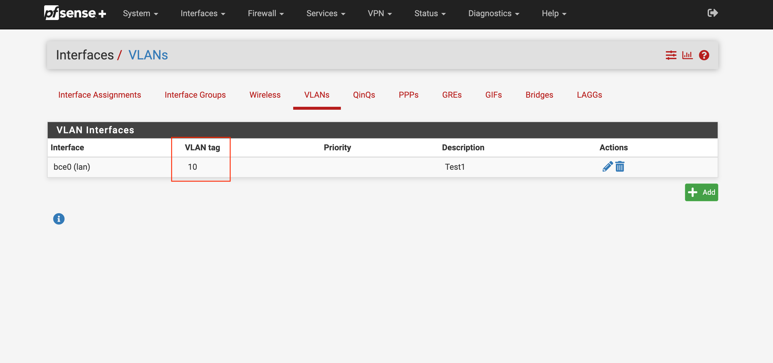

And finally, I have the pfsense with the VLAN as:

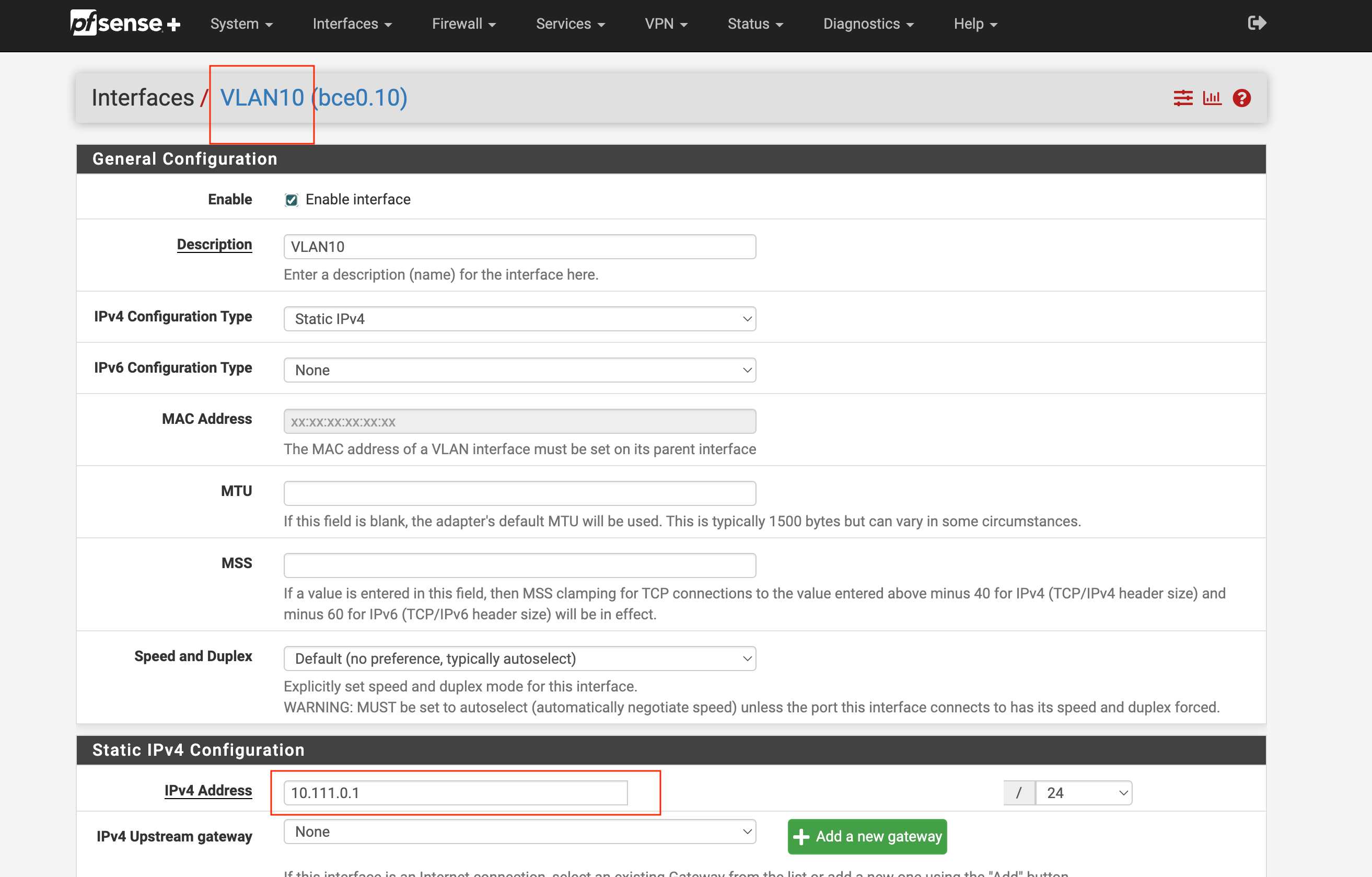

with an interface as:

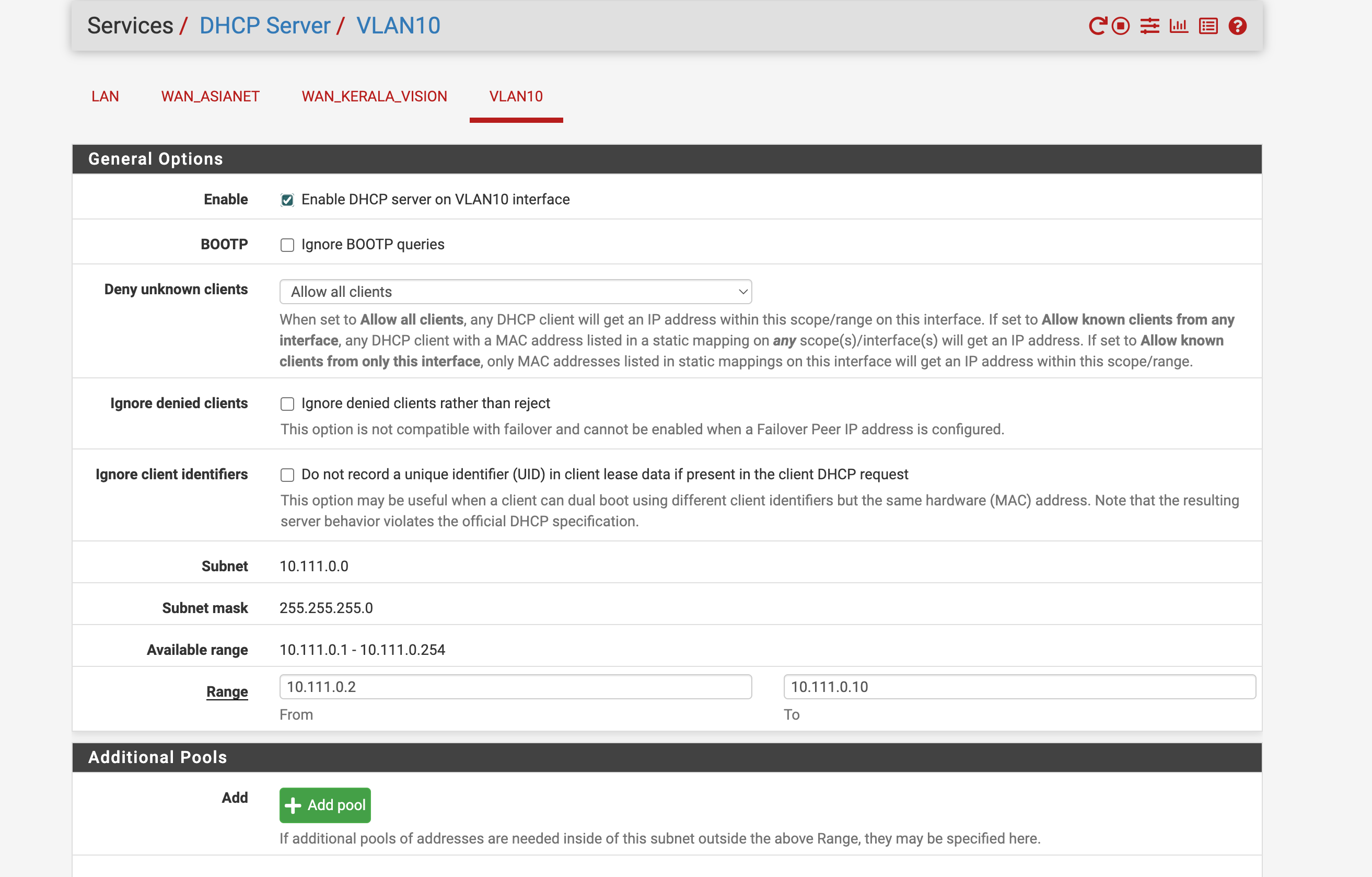

with DHCP server enabled as:
But, still, I do not get an IP address dynamically inside the VM.
What is the best way to troubleshoot this?
