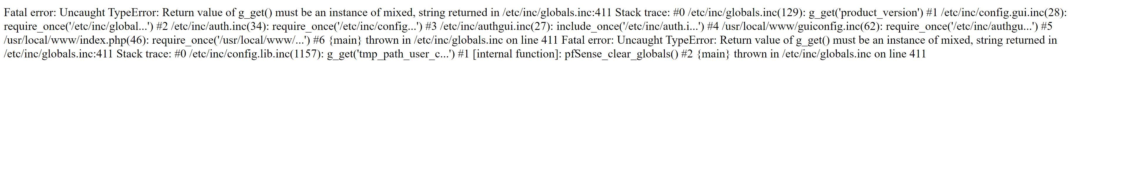

      I have a Pfsense / Netgate that's been running in a datacenter/rack for over a year that is only accessed occasially via VPN and serving as a local router for private IP and very basic firewall.
      I went to VPN this weekend and it gives me Auth Failure. I went to the Dashboard (public facing IP, I know bad security) I get long string below, nothing else. I have made no changes on this device in many months.
      Was it hacked or did the system just crash? It seems to still be running on some level as basic routing on the LAN is working using the Pfsense as default router.
      Code on web browser when accessing dashboard:
      Fatal error: Uncaught TypeError: Return value of g_get() must be an instance of mixed, string returned in /etc/inc/globals.inc:411 Stack trace: #0 /etc/inc/globals.inc(129): g_get('product_version') #1 /etc/inc/config.gui.inc(28): require_once('/etc/inc/global...') #2 /etc/inc/auth.inc(34): require_once('/etc/inc/config...') #3 /etc/inc/authgui.inc(27): include_once('/etc/inc/auth.i...') #4 /usr/local/www/guiconfig.inc(62): require_once('/etc/inc/authgu...') #5 /usr/local/www/index.php(46): require_once('/usr/local/www/...') #6 {main} thrown in /etc/inc/globals.inc on line 411 Fatal error: Uncaught TypeError: Return value of g_get() must be an instance of mixed, string returned in /etc/inc/globals.inc:411 Stack trace: #0 /etc/inc/config.lib.inc(1157): g_get('tmp_path_user_c...') #1 [internal function]: pfSense_clear_globals() #2 {main} thrown in /etc/inc/globals.inc on line 411

        Thats a typical PHP error message.
        Did you update to latest 23.01 recently?
        In some configs it seems that code is not matching PHP 8.0 requirements.

                    So you don't even see the login screen?
                    If there was no change made on the firewall then I would suspect a drive issue. If the boot drive fails services will fail over time as and when they need to read/write data. Without some sort of access it's hard to say though.
                      stormchaser5 @stephenw10
                      This is what the web page looks like when you go to the external web page (dashboard) to login. Just this string of characters.
                      A hardware failure, such as a disk sound plausable. But this XG-7100 is like a year and half old. So seems unlikely and is in a pristine enviroment, power/cooling and very low workload. In a few weeks will probably get to the bottom of it when I get console access. But it's very strange. I am glad it's still working on some level as a gateway.
