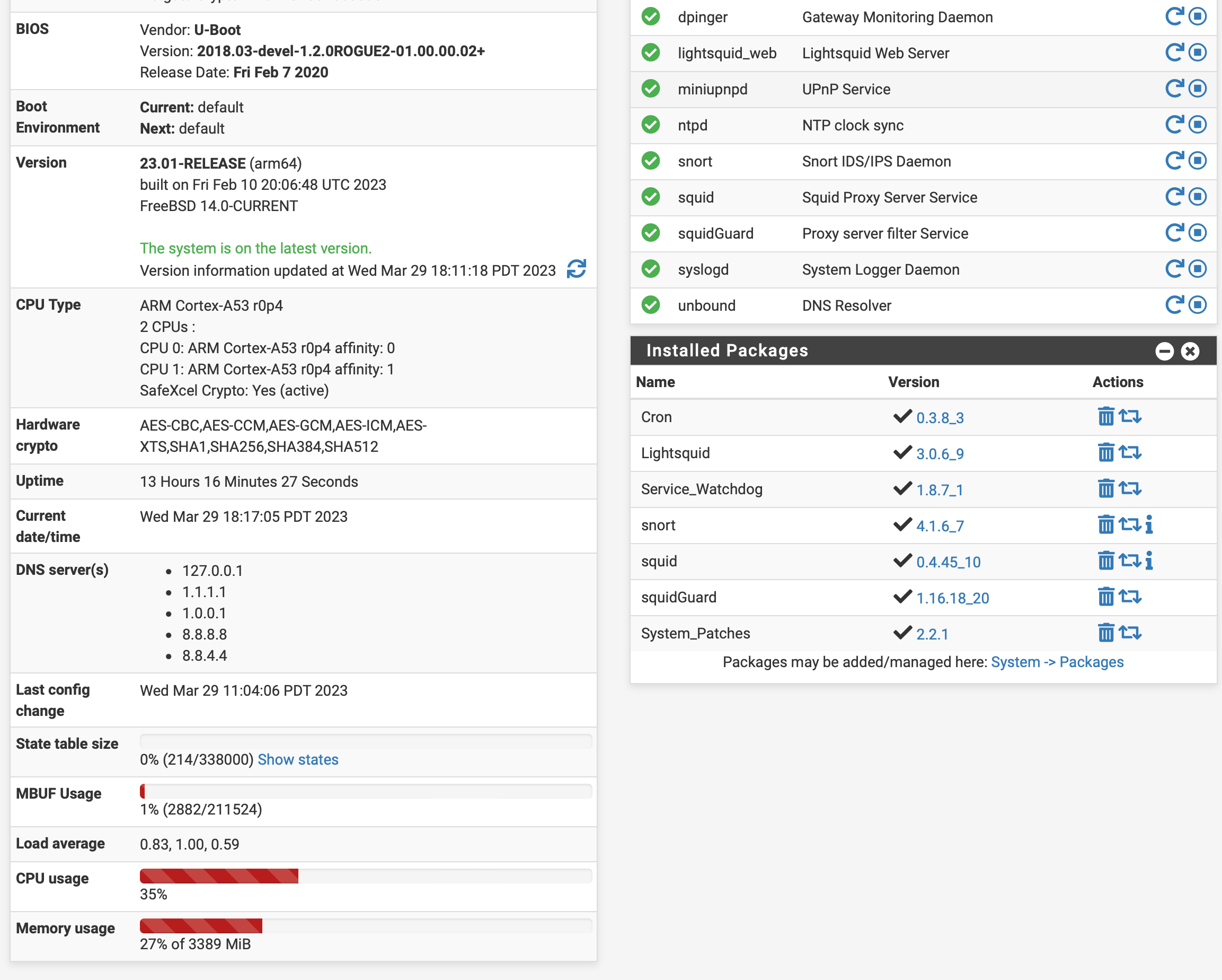

          Thanks for the reply, It seems to be working.
          (I do a reboot at 4:00 am each morning)
