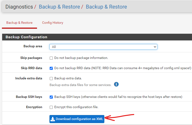

      After upgrading from 2.6.0 CE to 23.01 attempt to manually download a XML configuration file fails with a PHP error:
      alt text
      PHP ERROR: Type: 1, File: /usr/local/pfSense/include/www/backup.inc, Line: 108, Message: Uncaught Error: Call to undefined function gzdeflate() in /usr/local/pfSense/include/www/backup.inc:108

        rcoleman-netgate Netgate @apt
        @apt Have you installed the system patches package? If not do so and run all the updates and reboot your system.
        https://docs.netgate.com/pfsense/en/latest/development/system-patches.html
