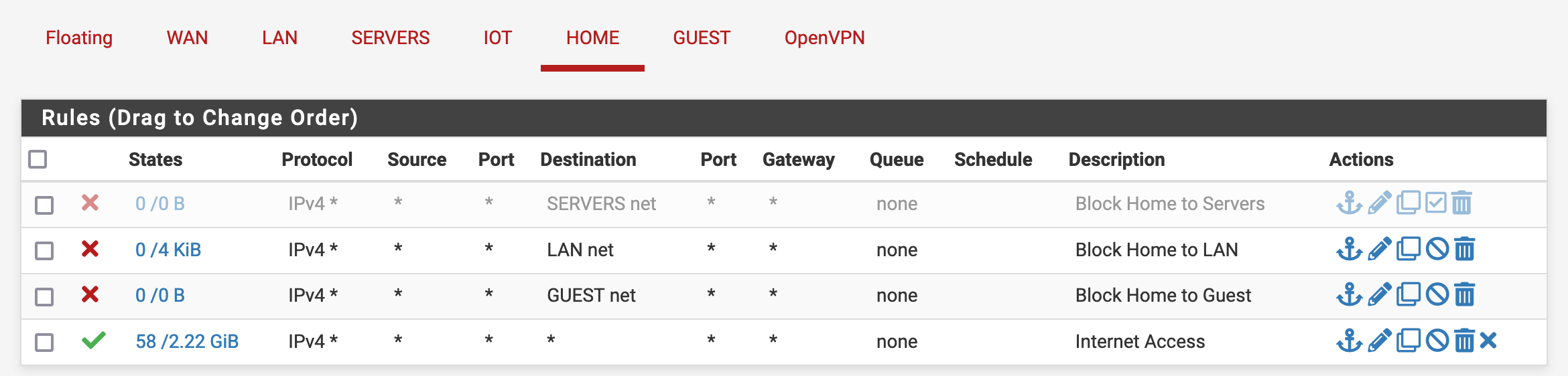

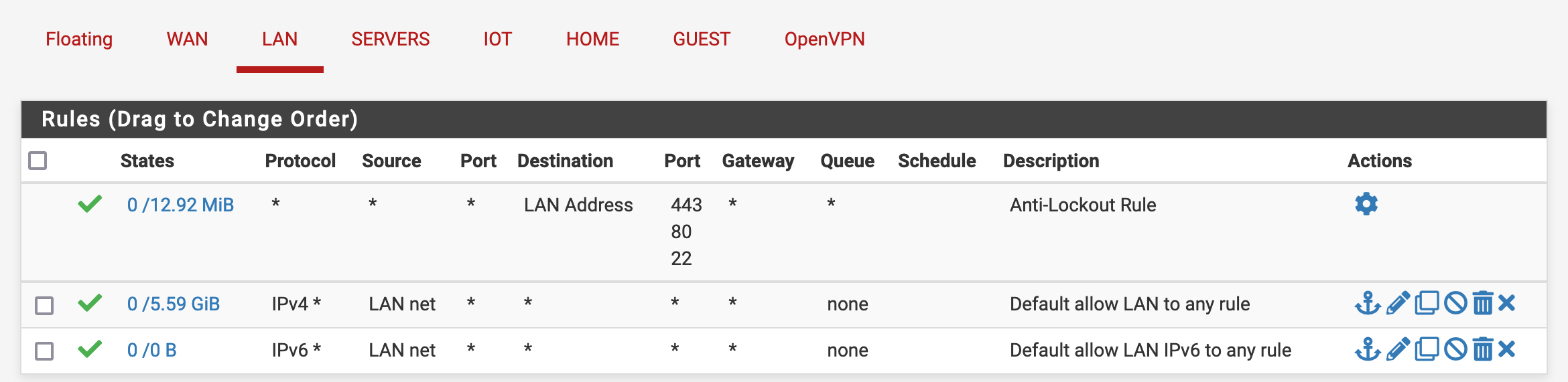

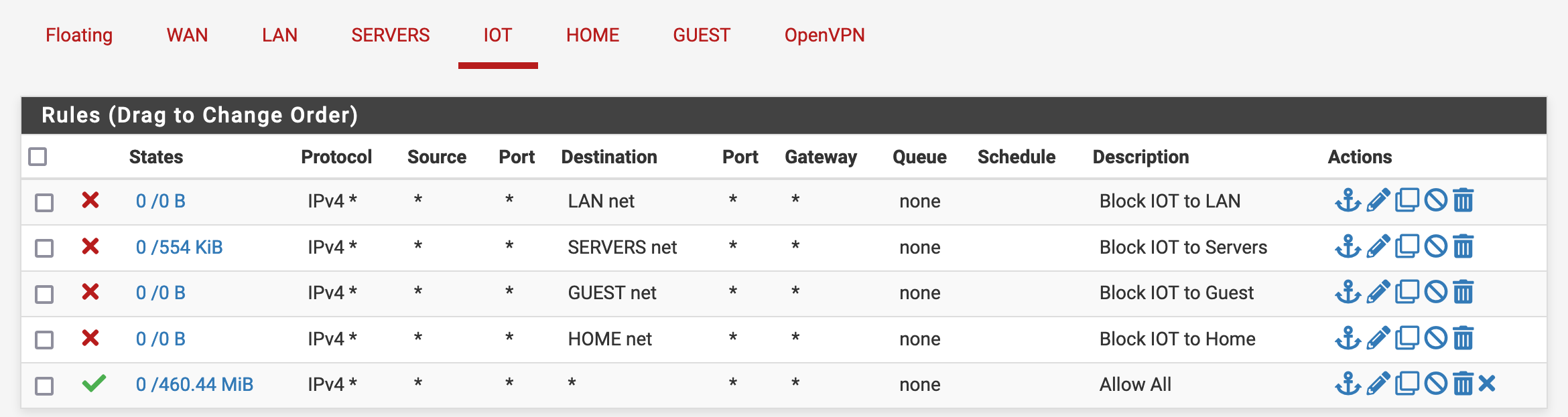

      Hey guys, I just got my pfSense router configured with some VLANs and wanted some input on how I set up the firewall rules. They seem to work as I intend for the most part, though they probably could be reworked to achieve the same result with less rules, but my main issue is my PC CAN NOT ping across these VLANs. I suspect this has to do with my PC and not the firewall rules because other devices CAN ping across VLANs just as think they should given the firewall rules I set up.
      Below I will include my firewall rules for each of my VLANs, what I'm trying to achieve with this setup, and what I have already tried to troubleshoot this
      Here is what I'm trying to achieve:
      LAN - 172.16.1.1/24 - Only devices on LAN are my unifi switch and AP
      Guest VLAN - 172.16.70.1/24 - VLAN for guest devices (internet access only)
      Home VLAN - 172.16.80.1/24 - VLAN for trusted devices at home (Needs access to NAS on Servers VLAN, and Philips Hue on IoT VLAN)
      Servers VLAN - 172.16.100.1/24 - VLAN for all servers (NAS on Servers VLAN Needs access to IP Cameras on IoT VLAN)
      IoT VLAN - 172.16.200.1/24 - VLAN for Iot devices (internet access only)
      These are the firewall rules I have for each VLAN:
      Screenshot 2023-05-21 at 19-44-35 pfSense.home.arpa - Firewall Rules LAN.png
      Screenshot 2023-05-21 at 19-44-48 pfSense.home.arpa - Firewall Rules SERVERS.png
      Screenshot 2023-05-21 at 19-45-02 pfSense.home.arpa - Firewall Rules IOT.png
      Screenshot 2023-05-21 at 19-45-28 pfSense.home.arpa - Firewall Rules GUEST.png
      Screenshot 2023-05-21 at 19-45-15 pfSense.home.arpa - Firewall Rules HOME.png

        @johan-2 Your Pc is on Home? Seems like it should work. Its gateway is correct? You can check for an open state when you ping…
        On Guest you may want to block to This Firewall ports 80/443/22 if you don’t want guests to be able to log in to pfSense. Allow DNS though.
