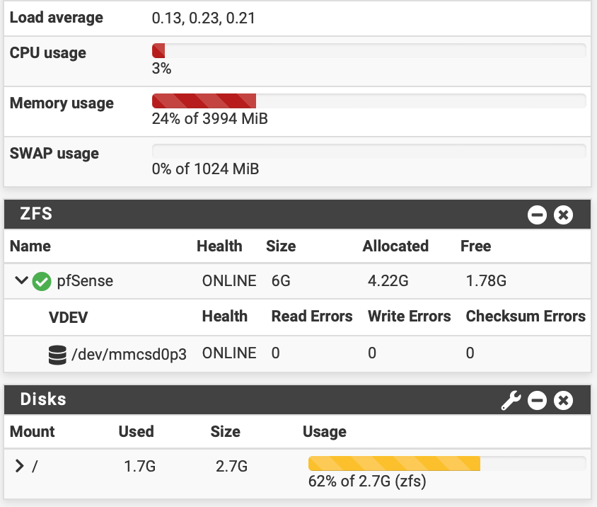

      SG-5100 running 23.01 (running zfs) had this disk usage (on 21May):
      Command output: SDD_Status (/bin/df -hi)
      Filesystem                            Size    Used   Avail Capacity iused ifree %iused  Mounted on
      pfSense/ROOT/default                  **4.0G**    1.5G    2.5G    38%     50k  5.2M    1%   /
      After upgrade to 23.05 I now have what seems to me as a large loss of free space:
      pfSense/ROOT/default                  **2.7G**    1.7G    1.0G    62%     49k  2.1M    2%   /
      Note the SDD Size is suddenly 2.7G rather than 4.0G. What is going on here?
      Is there some overhead that 'df' did not detect in 23.01 but no detects in 23.05? Or is my SDD suddenly deciding to croak (31 days after my warranty ran out)?

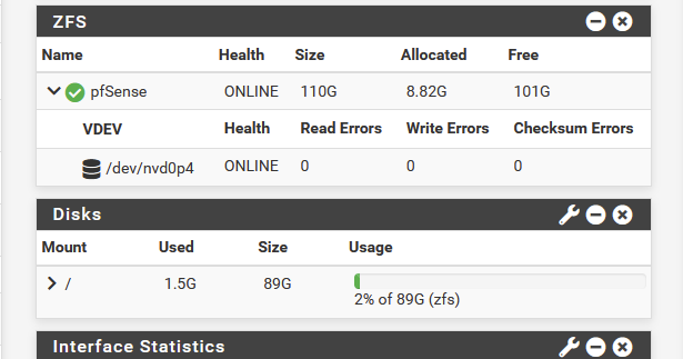

                JonH @Gertjan
                @Gertjan said in Why did my 4G SDD become a smaller size after upgrade?:
                Btw : 4 Gbytes for a system drive is ... very small.
                Don't have to tell me that. When I purchased my SG-5100 they said this is all it gets. Since it was replacing a dead 20G 2440 I was not exactly happy about that.
                  JonH @RobbieTT
                  @RobbieTT said in Why did my 4G SDD become a smaller size after upgrade?:
                  Hopefully this will give you a better overview as it is a bit confusing.
                  Thanks, you are correct. It is confusing. The geom command shows 2 geo names and I just don't get it. But I will research this.
                  What really messes with my head is that 23.01 dashboard mounted disk widget showed 38% used in 4G and after upgrade to 23.05 it is 62% used in 2.7G.
                  I have not restarted after 23.05 booted itself after install and I will get to that later when I can get to that.
                    Gertjan @JonH
                    @JonH said in Why did my 4G SDD become a smaller size after upgrade?:
                    I get it, as I said the same thing to myself : I've bougt a 4100, and waited until the "max' version came out : same device, with a 'normal' drive (110 Gb).
                    I've nothing an my pfSense : no big packages.
                    True, as I fool around with the system, dozens of snaps hots :
                    I could probably regain 4+ Gbytes easily.

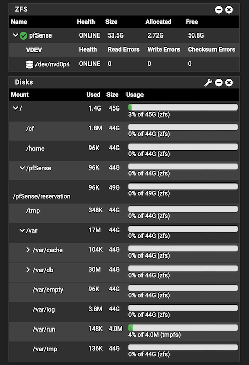

                      JonH @Gertjan
                      That was interesting view of widgets. I was unaware of zfs widget (I try not to fiddle with my pfSense, it usually gets me in trouble). So I loaded the zfs widget and it shows me an entirely different view of my system (6G size on 4G sdd?). I still don't understand why my system changed from 38% of 4G to 62% of 2.7G but at least I'm relieved to know that my sdd is not weird. I better read more about zfs.
