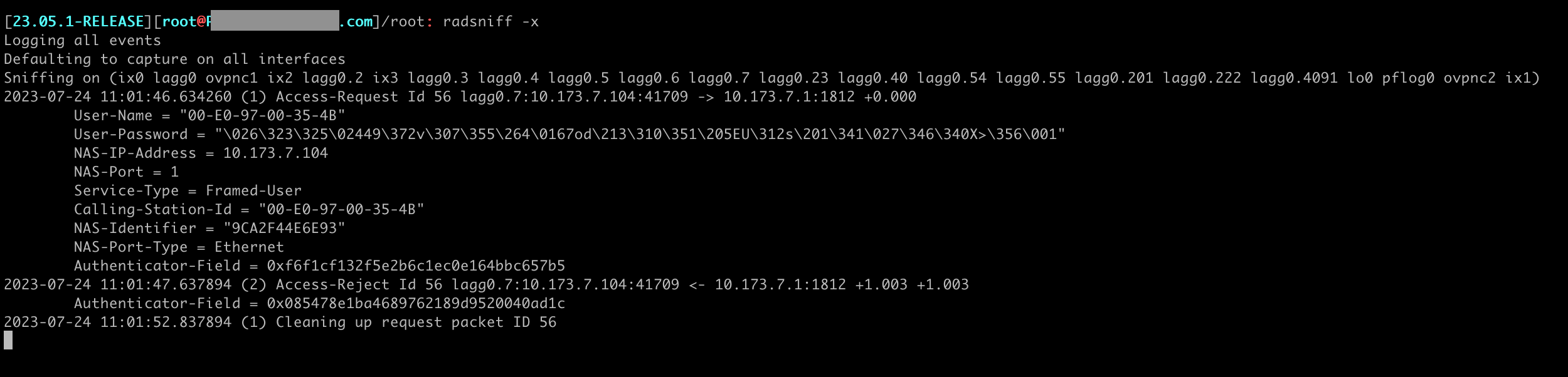

            @aaronssh Try running radsniff -x from a ssh session on your pfSense box
            aaronsshA GertjanG 2 Replies Last reply Reply Quote 0
            • aaronsshA
              aaronssh @NogBadTheBad
              @NogBadTheBad
              aaronsshA 1 Reply Last reply Reply Quote 0
              • aaronsshA
                aaronssh @aaronssh
                @aaronssh I am not sure how to read that output in the screenshot above other than it looks like FreeRADIUS is rejecting the auth attempt. I don't understand why.

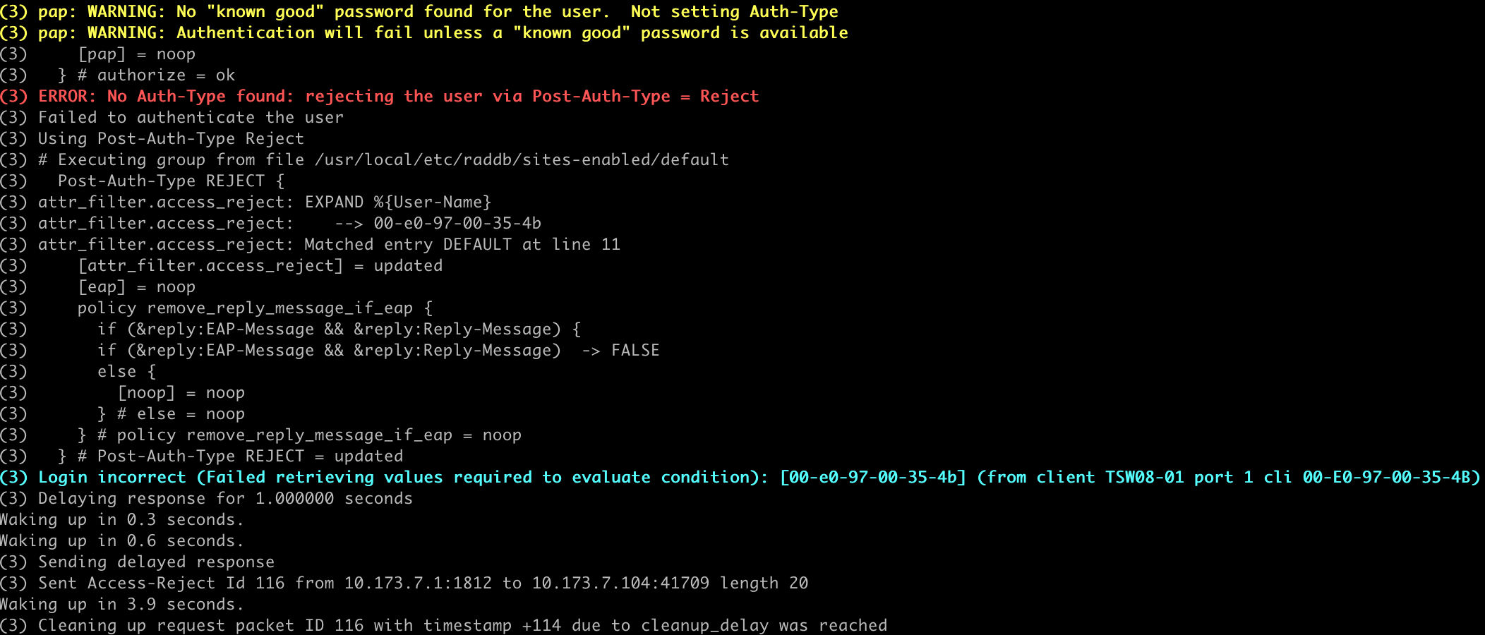

                • GertjanG
                  Gertjan @NogBadTheBad
                  @NogBadTheBad
                  radsniff is nice.
                  I'll add another one :
                  Shut down FreeRadius in the pfSense GUI.
                  On the pfSense command line (SSH - NOT GUI !!) or console : menu 8 :
                  radiusd -X
                  Enjoy.
                  Totally useless, but I say it anyway : if you think FreeRadius doesn't show something, then this means it didn't receive something.
                  Also, terminology used is rather cryptic. Radius is .... well .... Radius.
                  • aaronsshA
                    aaronssh @Gertjan
                    @Gertjan said in FreeRADIUS MAC authentication:
                    radiusd -X
                    I do get a lot more info that way, but I don't know how to interpret what I'm seeing here. Can you determine what this means?
                    • GertjanG
                      Gertjan @aaronssh
                      @aaronssh
                      Welll ... I never used pfSense Freeradius to do MAC authentication / identification.
                      I do see the same :
                      4b1fa98f-8e9f-4fd5-b9ff-a50cec877df3-image.png - consider this one harmless.
                      I don't know who is 10.173.7.104 neither 10.173.7.1 (probably : pfSense but it has a strange LAN IP)
                      00-e0-97-00-35-4b looks like a MAC. From what device ?
                      Etc.
                      I'm the more basic "user + password" guy.
                      The pfSense documentation hasn't a doc / example for you ?
                      • aaronsshA
                        aaronssh @Gertjan
                        @Gertjan
                        10.173.7.104 is the switch
                        10.173.7.1 is pfSense
                        00-e0-97-00-35-4b is the MAC address on my Macbook
                        So all of that looks right to me, and I don't understand why it is rejecting.

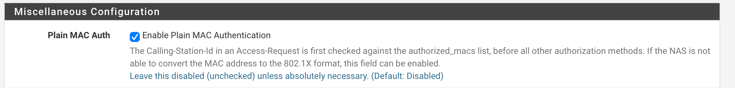

                        • keyserK
                          keyser Rebel Alliance @aaronssh
                          @aaronssh Perhaps you forgot to enable MAC bypass in Freeradius since your client is 802.1x challenged?
                          • aaronsshA
                            aaronssh @keyser
                            @keyser I noticed that and tried it both ways, but it does not change the result or the error messages.
