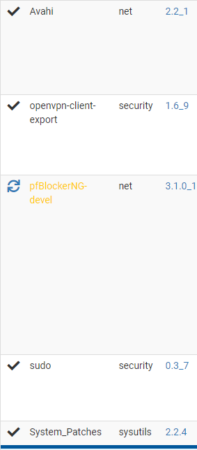

                          • Y Offline
                            yquirion @stephenw10
                            @stephenw10 The one I'm more concerned is pfBlockerNG-devel. I don't want to lose my configs. Here are all the packages I'm using:
                            If I need to remove them, will I lose all my configuration parameters?
                            Regards,
                            Yanick

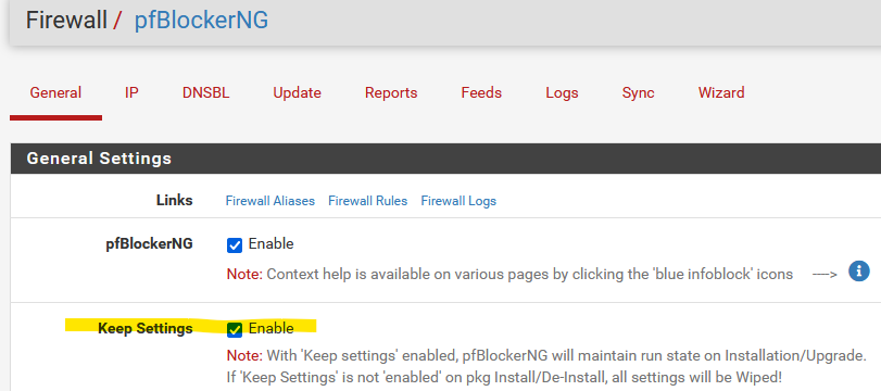

                                pfBlockerNG
                                Upvote 👍 helpful posts!

                                  • stephenw10S Online
                                    As @SteveITS said, you should not lose the settings by removing the packages and then reinstalling them.
