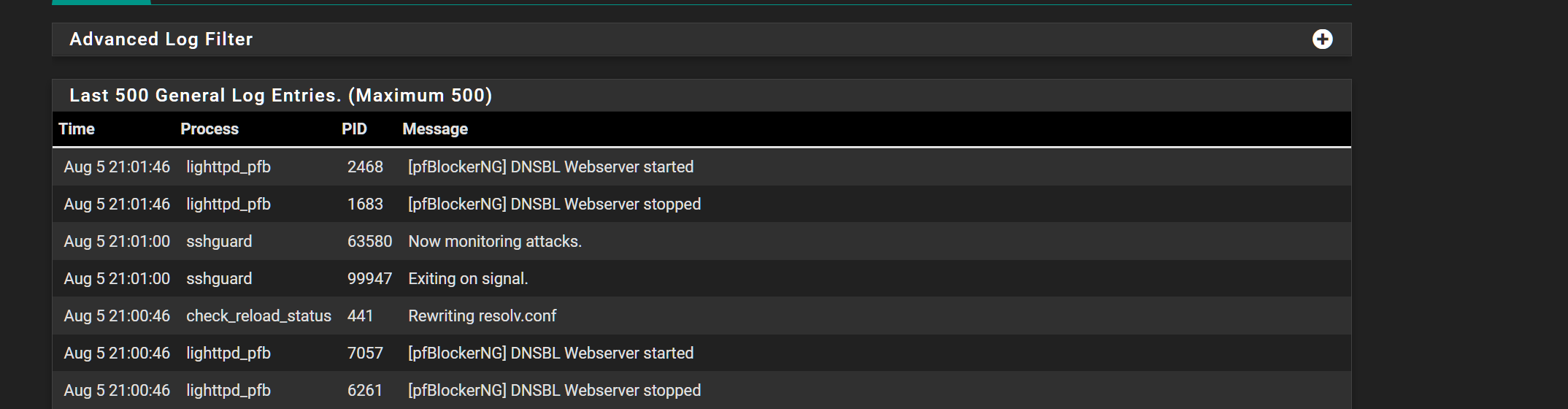

                              The problem has come back.
                              Restarting unbound or dnbl doesnt solve the problem. The only solution is to disable DNSBL and cpu util goes back to normal.
                              I honestly have no idea and im at a lost.
                              I reinstalled the package from completely not saving any settings.
                                 11 root        187 ki31     0B    64K RUN      2 862:26  87.99% [idle{idle: cpu2}]
                                 11 root        187 ki31     0B    64K CPU3     3 835:22  84.28% [idle{idle: cpu3}]
                                 11 root        187 ki31     0B    64K CPU1     1 851:44  77.69% [idle{idle: cpu1}]
                              18451 unbound      68    0   235M   202M kqread   1   7:55  46.19% /usr/local/sbin/unbound -c /var/unbound/unbound.conf{unbound}
                              18451 unbound      68    0   235M   202M kqread   1   0:00  46.00% /usr/local/sbin/unbound -c /var/unbound/unbound.conf{unbound}
                              18451 unbound      68    0   235M   202M kqread   0   0:00  46.00% /usr/local/sbin/unbound -c /var/unbound/unbound.conf{unbound}
                              18451 unbound      68    0   235M   202M kqread   2   0:00  46.00% /usr/local/sbin/unbound -c /var/unbound/unbound.conf{unbound}
                              Wireless: Unifi, Aruba IAP
                              JNCIP,CCNP Enterprise
                                michmoor LAYER 8 Rebel Alliance @michmoor
                                Interesting...Checking the DNS logs i see the same script being loaded over and over again.
                                Im still poking around. No clue right now :)
                                Whats also so weird is that unbound keeps restarting..

                                    @stephenw10 I think i solved it. Im fairly confident its solved now....i hope 🤞 😁
                                    The clues are in the DNS logs. I noticed Unbound kept restarting and i remember a while ago reading on the forums that DHCP registration causes Unbound to restart. I do have registration enabled for all VLANs so i wasnt totally buying that as a reason. Regardless I reviewed each DHCP configuration for the vlans and what do i find?
                                    Ahhh this aggressive lease timer. I stood up new DNS servers for a vlan and needed clients to switch over quickly. I never updated this until today. Switched back to defaults and CPU utilization shot back down to normal baseline levels.
                                    Someone correct me if im wrong but i thought the DHCP registration issue with needed Unbound to restart was solved in the latest release?
                                      Part of that issue was solved but it still restarts Unbound to load the new values every time. Which is.... sub optimal!
                                      Yes, 60s is very short. Any reason it was set to that?
                                        @stephenw10 said in CPU usage increase suddenly:
                                        I stood up new DNS servers and wanted devices to cut over right away which worked but caused an issue for myself.
                                        This entire issue smelled like a config problem but i couldn't prove it at the time. I went against my rule of rebooting the firewall as i truly dislike doing that especially if things were working before.
