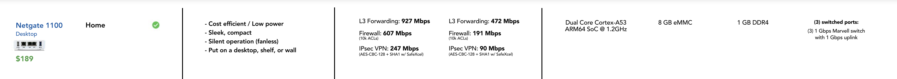

      Now I'm looking at MikroTik routers and I landed on the RB960PGS: https://mikrotik.com/product/RB960PGS
      According to the specifications, the RB960PGS has a single core 800MHz processor and only 128MB of RAM, yet the test results page suggests that it out performs the SG1100 that has a 1.2GHz dual core arm processor and 1GB RAM by a lot.
      It raises a lot of questions. I'm wondering how can the RB960PGS outperform the SG1100? I'm guessing it's the switch chip can someone confirm? Is that why the SG2100 is quite a bit better than the SG1100 with similar specs? What will I miss out on if I go with the MikroTik router with RouterOS over the Netgate router with PFSense? The MikroTik router takes a hit with having more IP filter rules. Does it still take a hit on the SG1100 with the faster processor?
      Most importantly: will I be able to fully utilize my 1Gbps connection with the firewall enabled on my SG1100?
      I think the router is just going to be a firewall + router for me. I may setup DNS, but I'll put it on a server if it's a performance hit to the router. Then again, with all that extra processing and RAM, the DNS server should run on the SG1100 like it's not even there, right?
      I'm going to pull it out of the box where ever it is sometime soon, but can anyone give me a head start on answering some of those questions or push me in the right direction?

        rcoleman-netgate Netgate @shea
        @shea said in advice on new home network and curious about SG1100 vs MikroTik's RB960PGS:
        A few reasons:
        1. The 1100 has a single ethernet IC that runs at 1Gbps and is shared between the three ports
        2. They run very different operating systems.
        Ryan
        Wireless: Aruba, Ubiquiti
          No. See my previous message.
          In a best-case scenario you'll get 600Mbps but without any filtering going on.

            shea @rcoleman-netgate
            @rcoleman-netgate said in advice on new home network and curious about SG1100 vs MikroTik's RB960PGS:
            I think that has to be the bottleneck for the 1100 throughput, because 2100 proves the CPU/OS is capable of more with a better network chip.
            1. They run very different operating systems.
            Is that to say RouterOS performs well with 800MHz, or is that to say pfSense is inefficient?
            Does it seem significant that the RouterOS throughput at 800 million cycles per second, comes very close to the pfSense throughput at 2.4 billion cycles per second?
            I think I just figured it out as I was typing that last sentence: I think pfSense is overall marginally less efficient, but the nic portion is a bottleneck for the 2100 and especially for the 1100. I assume the nic/network/switch chip would stack/grow the more ports you use. I think the 2100 could handle a much higher throughput with more ports, but the CPU is intentionally better than needed to support packages and other additions to pfSense, which is why the dual 1.2GHz seems disproportionate to the single 800MHz. Apparently the firewall throughput isn't directly determined by the CPU speed, and the nic is more involved with the firewall than I had thought, because the firewall throughput on the 1100 is quite bad, despite having a better CPU. I think I would need to learn more about these "IP filter rules" to understand why that is.
            Ultimately I guess everything else is irrelevant and this is what it all comes down to.
              No, Linux and FreeBSD are very different platforms.

                    @shea The 2100 has a similar CPU to the 1100 but has a separate NIC for WAN.
                    “Working in the GUI” could well be eMMC write speed (which is inherently not fast). Note the 2100 has 4GB/4x the RAM so can better use a RAM disk. The 2100 also has a max version with an m.2 drive.
                    I don’t see you said what your current bandwidth is..? As alluded to above I suggest figuring out your needs/goals, then choose software, then choose hardware.
                    Upvote 👍 helpful posts!
                      I'm pretty sure that Mikrotik platform will be using some hardware offloading to pass traffic without having to process each packet. You can see that by how much slower it is with only 25 IP filtering rules. I'm assuming the 'simple rules' that do not slow throughput are handled in the offloaded path but anything more complex cannot be. There are quite a few devices that behave like that. Big numbers until you try to do anything complex when throughput tanks. The 1100, like anything running pfSense, uses pf for all filtering. No hardware ACLs.
