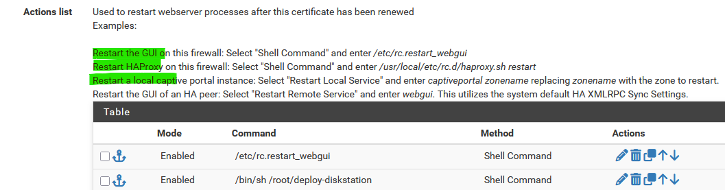

          @Maxpower said in Issue with ACME Certificates Refresh & Restarting HAProxy:
          For this, I have configured the command /usr/local/etc/rc.d/haproxy.sh to restart HAProxy, as its described in the GUI
          What exactly did you do here ?
          Can you go into detail ?
          EChondoE 1 Reply Last reply Reply Quote 0
          • EChondoE Offline
            EChondo @fxandrei
            @fxandrei Found this thread via Google. And I figured out what OP did, so here's the explanation:
            In the pfSense webpage do:
            1. Click on "Services"
            2. Select "Acme Certificates"
            3. Edit any of your certificate entries by clicking on the pencil icon.
            4. Scroll to the bottom of the certificate edit page and find the "Actions list" section.
            5. Click on "Add" to add a new action and fill out the information as needed. For HAProxy restarting do:
              1. Mode: Enabled
              2. Command: /usr/local/etc/rc.d/haproxy.sh restart
              3. Method: Shell Command
            6. And finally "Save" at the bottom of the cert edit page.
            As far as I can tell, the above action seems to propagate to all certificates that I have, not just a single one. I am not sure if this is just a visual bug, but just something to be aware of.
            I haven't been able to confirm if the above works(mine just renewed, don't feel like doing it again just to test), so we'll see in 60 days I guess.
            Hopefully this helps you and anyone else that finds this thread via searching.
              Gertjan @EChondo
              @EChondo
              What's your pfSense version ?
              The instructions are shown here :
              A restart of a service will start by re creating their config files. If a certificate changed, it will get included. When the process starts, it will use the new certificate.
              @EChondo said in Issue with ACME Certificates Refresh & Restarting HAProxy:
              No need to wait x days.
              You can re test / renew right away, as you are 'allowed' to renew a couple (5 max ?) of times per week.
