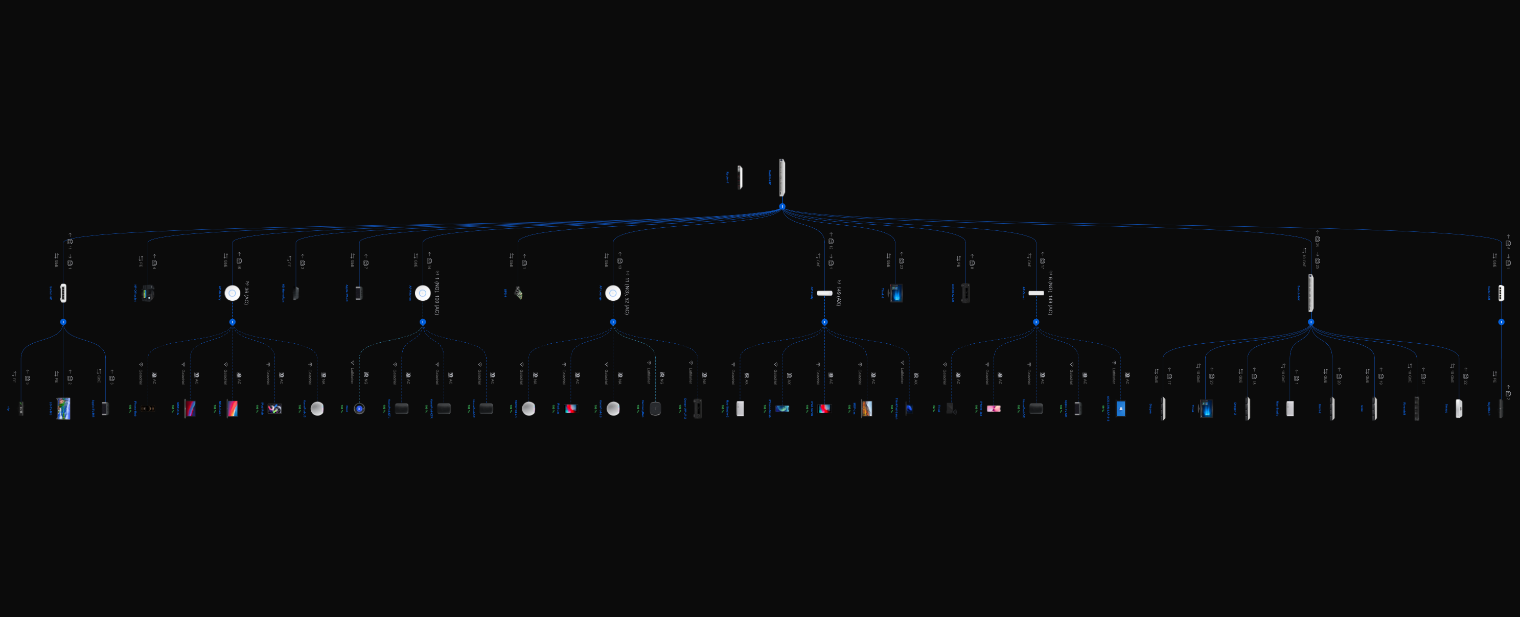

                                    RobbieTT @stephenw10
                                    @stephenw10 said in Web Configurator traffic is not being fragmented when it should be:
                                    Well it could be that I only ever see problems. 😉
                                    Yeah and medics only meet the sick & wounded. Who knew? 🤷
                                    My home network above is not massive, almost fits on a page, even with working-from-home stuff. Typically there is less than 50 devices and often much lower than that; but there is a mix of old and new, IoT to servers, UPS to NTP, Windows (ugh) to 'nix, protocols to proprietary, NASes to thermostats and all working perfectly at their preferred MTUs.
                                    Thankfully my Netgate device joined this melee without a murmur or a dropped packet. No complaints from this direction, even at L2. 👍
