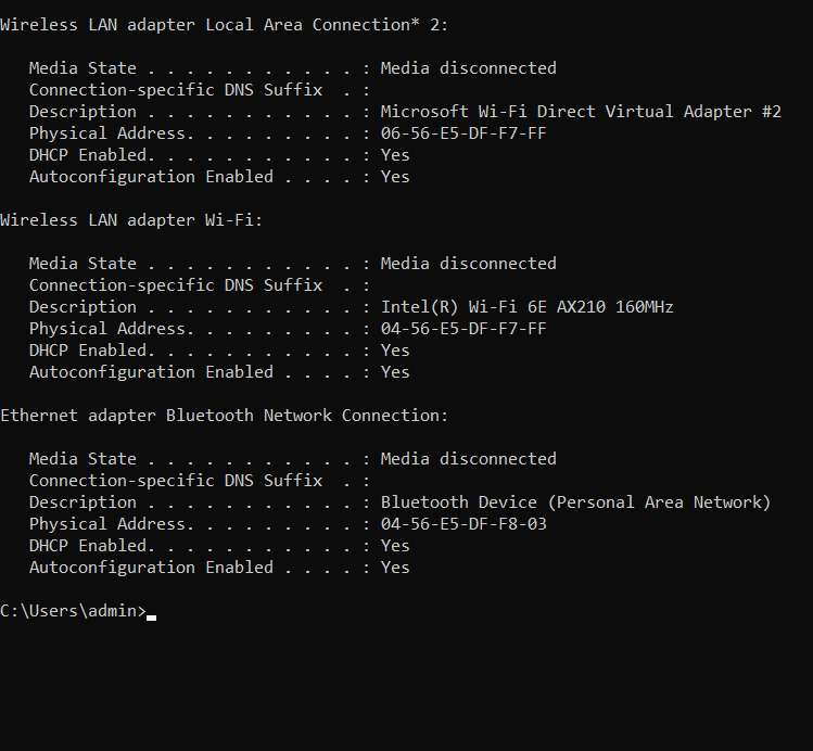

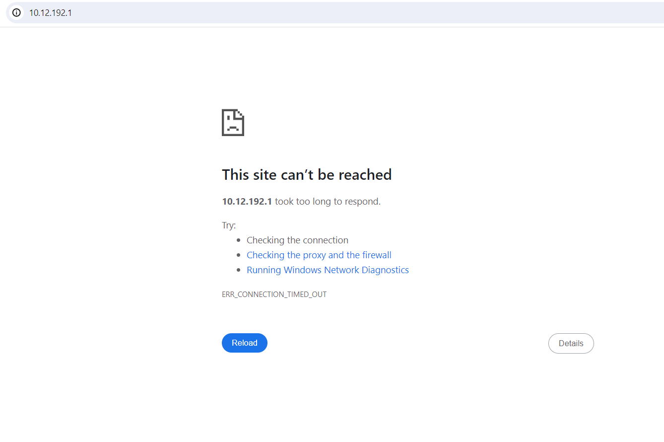

                        @johnpoz Thanks a million for your help! I hate to keep asking questions. There must be something wrong with my settings as I've followed those steps to a T and I'm still getting issues. When attempting to manually change this device's ip address to 10.12.192.2, i get the below error:
                        I'll post similar and will show what happens.
                        After I hit apply changes, the tab attempts to reload and after about 30 seconds, this message pops up:
                        I try to manually change the ip of the machine:
                        ipconfig /all
                        After finagling and not successfully configuring, I factory reset the netgate via putty and try again.
                        I am able to see the LAN as 10.12.192.1/24 in Putty
                        • johnpozJ Online
                          johnpoz LAYER 8 Global Moderator @LMorefield
                          @LMorefield you didn't have to set the dns ;)
                          That is a windows issue that it is not allowing you to set your pc IP.. I never use that settings, I just go to the properties of the nic..
                          Ah - MS doesn't let you set mask with 255.255.255.0 there, you need to use the prefix length, which would be 24 in this case, and also seems it won't let you save unless you set gateway..
                          What about if your going to force specific settings/values - give details of what is wrong, vs saying check settings..
                          I just set settings here..
                          L 2 Replies Last reply Reply Quote 1
