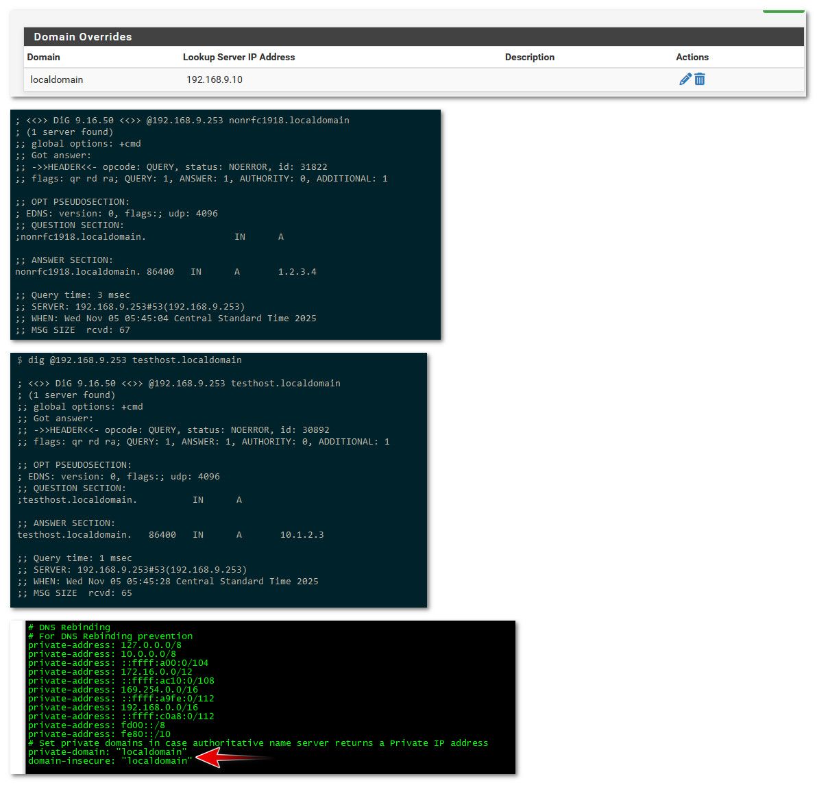

                  edit: ok setting a domain override does seem to auto add the private domain. I haven't used my test setup of this in a while.. But here setup a domain override.
                  See my domain override works for both public or rfc1918
                  If I look in my /var/unbound/unbound.conf you can see that the private domain localdomain was added
                  What version of pfsense are you using - if old, this might not work.. But first step in troubleshooting this is validating if a client on your local network queries pfsense IP for some record in your override domain is you get an answer.
