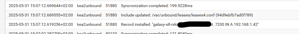

                                      @herbcso said in KEA DHCP missing "Register DHCP leases in DNS Resolver...":
                                      it sounds to me like KEA should now support resolving DNS names, right?
                                      Exact.
                                      I'm using pfSense Plus which had that issue solved months ago. Works just fine.
                                      Example :
                                      a phone connects on my 192.168.1.0/24 (LAN) network, and got a lease from the pfSense kea DHCP server on that network.
                                      The "kea2unbound" script is the "bridge" (glue-ware ^^) that gets the IP and host name, and communicates it to unbound.
                                      From now on, the IP con be resolved to the host name (reverse resolution) and host name to IP (resolution).
