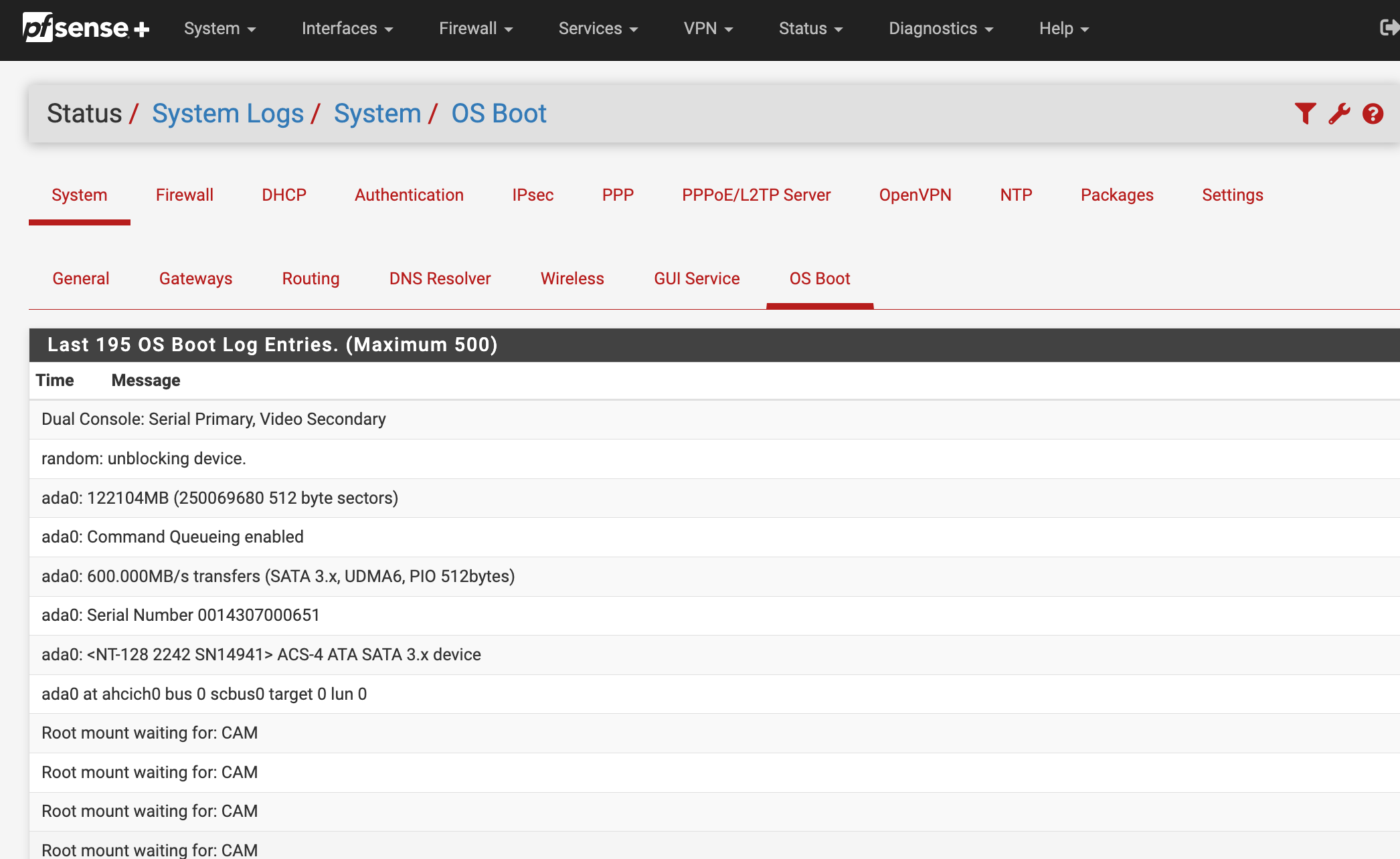

Resolved: 23.09.01 Boot Loader logs hang at Dual Console: Serial Primary, Video Secondary
The bootloader logs hang at
Dual Console: Serial Primary, Video Secondaryand no longer display California University copyright information
How can I fix this I have a 2100 it does not use 2 video outputs
It normally displays this at the end after 23.09.01 upgrade it just hangs in logs

Wouldn't it show at the top like it use to??
Yes, it does. It looks like you have the logs set as reversed though in 23.09.1, hence it's at the bottom of the page.
Weird I never changed that, is that a config.xml item?
Yes there's a general settings for in the log settings but you can also set it for each log.
