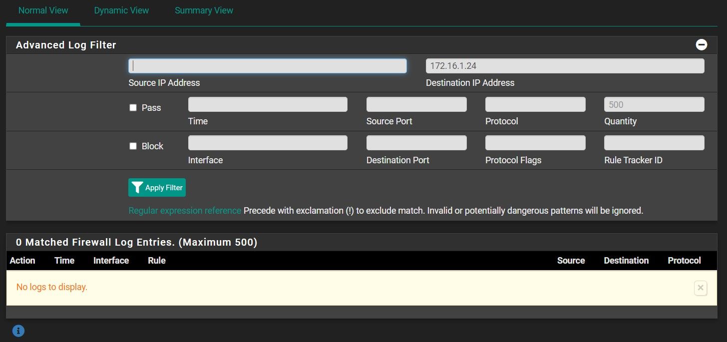

        When it fails do you see blocked traffic in the firewall log?
        Anything in the system log?
        Do you have any packages installed?

          Thanks for your reply, there are no logs for the local IP.
          Diagnostic states: local IP 172.16.1.24 to whatsapp servers.

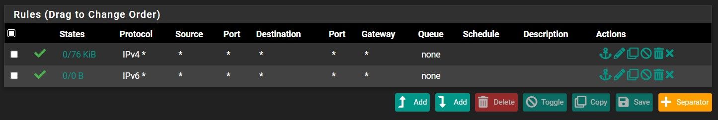

            Hmm, you have allow all rules (wide open) on the WAN? Is it behind some other firewall/router? Otherwise you definitely don't want rules like that on WAN!
            I assume you also see states, with NAT, on the WAN interface?
            • F Offline
              fredis @stephenw10
              I configured 'allow all' only for troubleshoot purpose, however the issue persists, it means, the firewall rules are not blocking the traffic.

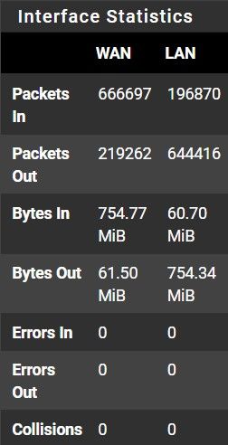

                    Any errors shown in Status > Interfaces?
                    MTU mismatch somewhere?
                    If nothing changed in pfSense did anything change in the ISP router?
                    • F Offline
                      fredis @stephenw10
                      There are not errors on interfaces.
                      MTU: default values: 1500 bytes.
                      [23.09.1-RELEASE][admin@pfSense.home.arpa]/root: ifconfig | grep mtu
                      mvneta0: flags=1008a43<UP,BROADCAST,RUNNING,ALLMULTI,SIMPLEX,MULTICAST,LOWER_UP> metric 0 mtu 1500

                      ISP discarded some issues.
                      When bypass the SG-2100, the issue is resolved.
                      All tests point to SG issue, but I don't sure what is the RCA of the issue.
                      Fredi
