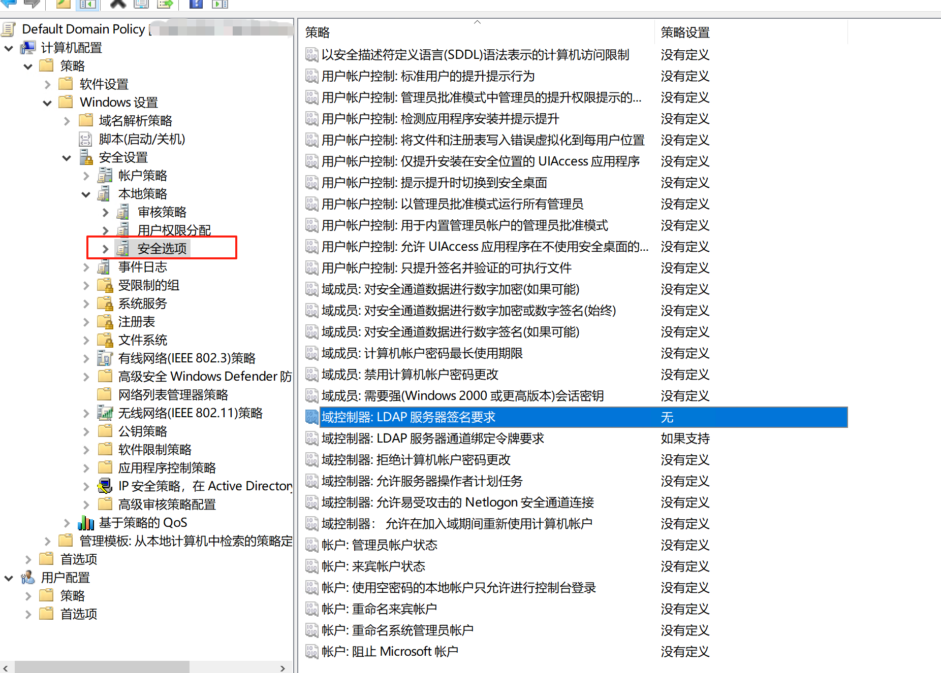

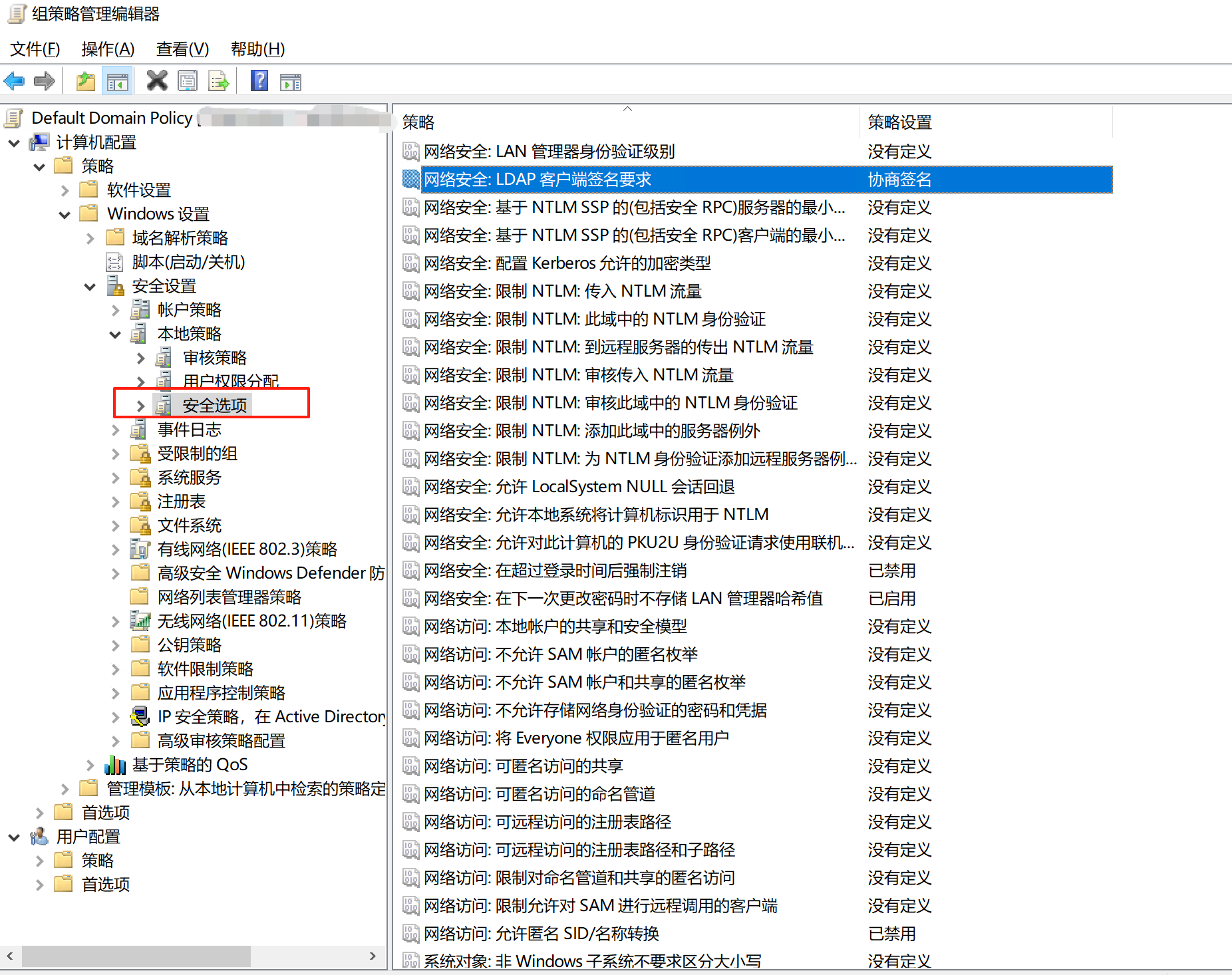

                  • G Offline
                    guilin_sh
                    My operating system is Windows Server 2022. I noticed that the default group policies of my domain controller are somewhat different from yours. Currently, I'm also having issues with failing LDAP connections via ports 389 and 636, but I can connect successfully using GSS-API SASL. I almost gave up, but after seeing your post, I've regained hope. Since various systems currently only support connections via port 389 or 636, I still hope to prioritize using port 389.398c0123-f27e-4b3d-83ad-74357589cf66-image.png
