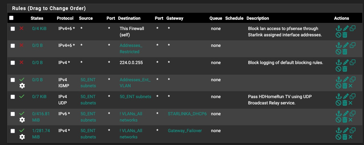

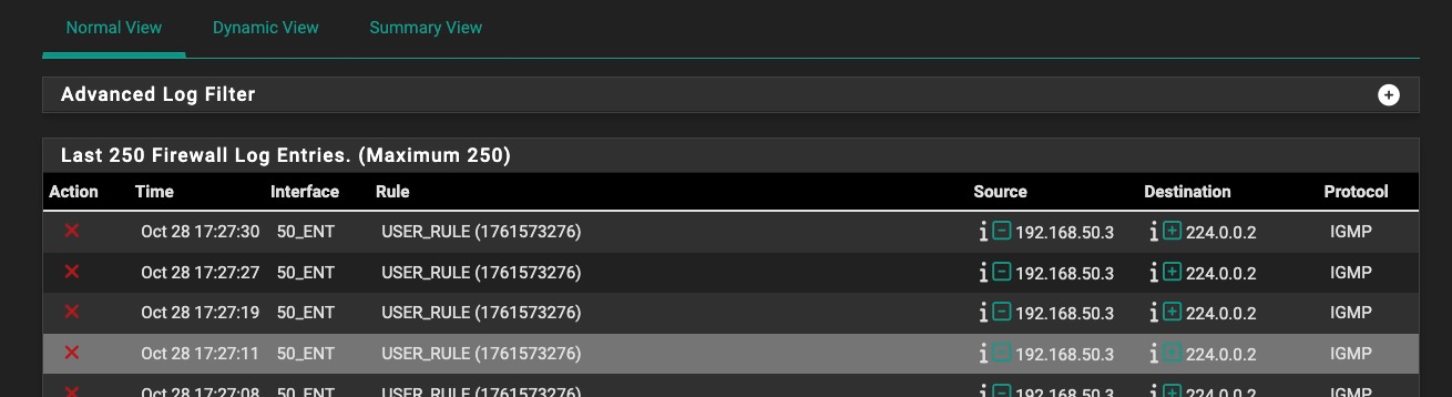

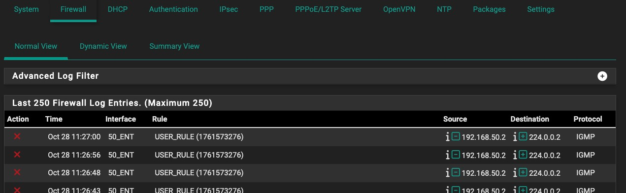

                        The "blocked" logging from 50.2 returned this morning without any pfSense changes:
                        Rule *3276 is my Entertainment VLAN pass rule for policy routing:
                        I have a IGMP pass rule at the top with Allow IP Options enabled and logging disabled:
                        • dennypageD Offline

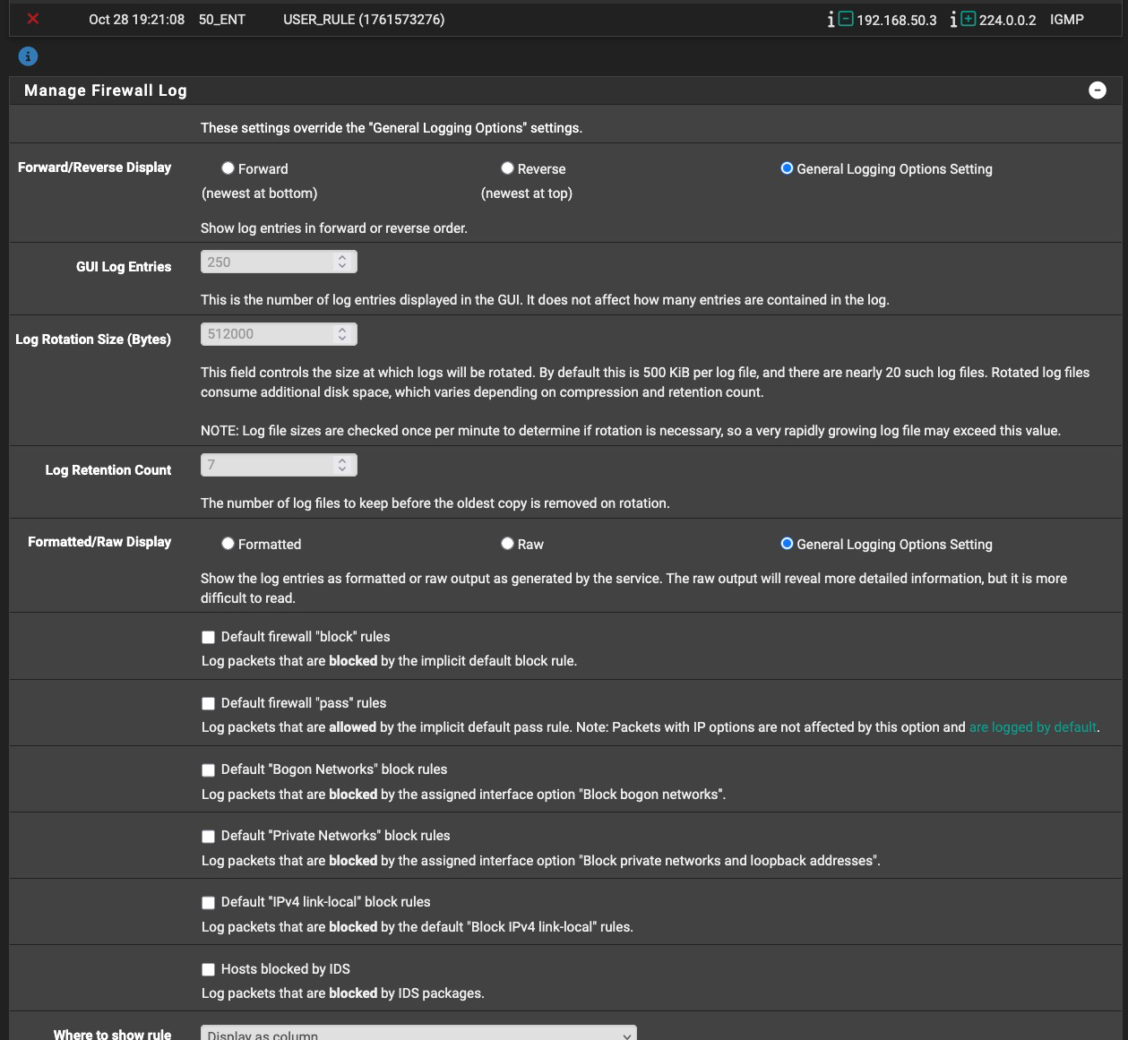

                              Mission-Ghost
                              Spoke too soon. The mystery log messages have started up again while I was doing another pcap against igc0.50:
                              [.50.3 is the other Roku box (hard wired....50.2 is the WiFi Roku box)].
                              Rule 1761573276 is the policy routing rule for the .50 VLAN, which is set to not log and is below the IGMP pass rule. I modified the IGMP pass rule (with the Allow IP Options enabled) to match on the log source and destination addresses specifically, the log still comes out from the policy routing rule.
                              This just seems buggy. I'll have to reboot again when I get an maintenance hour and see if that stops it again.

                                Have a look at the checkbox options on the options Status / System Logs / Firewall (wrench icon). One of those options may affect what you are seeing. Also read here. @stephenw10 may have additional suggestions.
                                This really should be broken off into a new thread. Be sure to include information about your interface configurations and rules.
                                  Mission-Ghost @dennypage
                                  @dennypage Thanks again for the helpful discussion.

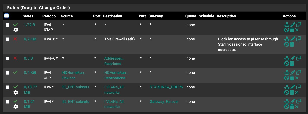

                                  All of the check boxes for logging bogons etc. under Status/System Logs/Firewall > Manage Firewall Log are unchecked, and unchanged from prior to this issue (I have not set the system to do Firewall logging which is why this issue is noticeable. The firewall log should be empty on my system all the time.)
                                  I re-read the section you pointed me to (I have read it before--but I did not have anything logging prior to this mystery so it was unneeded before). So to be scientific about it, I put a block-all-no-logging at the end of the .50 VLAN rule set, to no effect. First I put a block no log rule to 192.165.50.255. When that didn't work, I changed it to the one shown below to block all no-logging to the IGMP broadcast address. The mystery logs continue to be posted from the prior policy routing rule that is being attributed to by the log records.

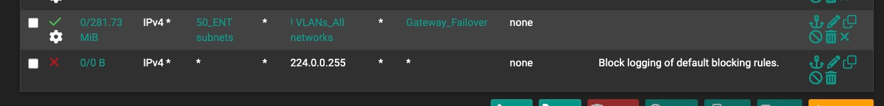

                                  So I moved this block-no-log rule above the policy routing rule, to no effect.
                                  Still getting log records attributed to the policy routing rule.

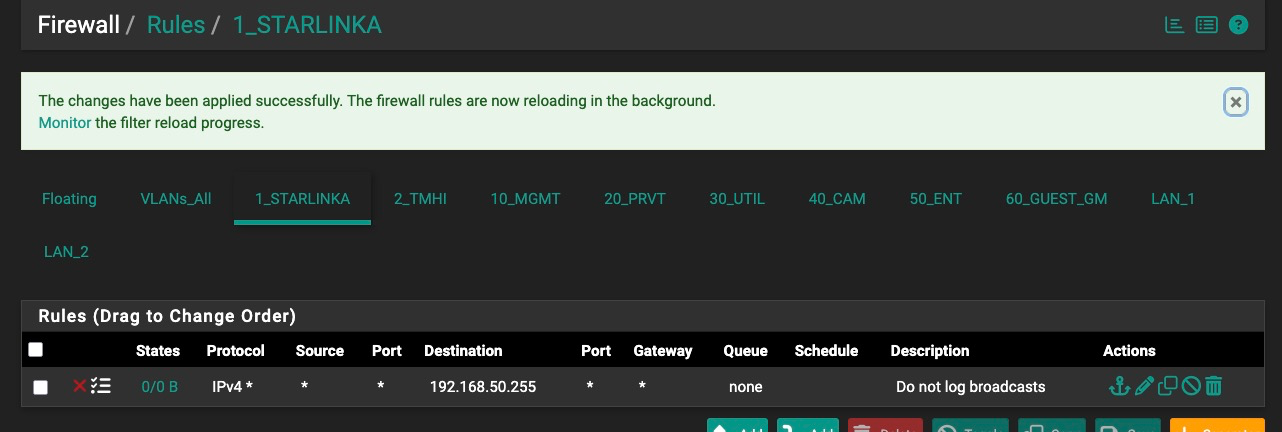

                                  To be thorough and consistent with the documentation example you referenced, I put a block-no-log rule on the Starlink WAN rule set to no effect (I set it to log, first, then to no log, neither one made a difference as inbound Starlink traffic has not been logging anyway):
                                  Because overkill is underrated, I also then copied the rule to the TMHI backup-internet interface, to no effect.
                                  Of course, the problem isn't incoming from the Internet, but I want to demonstrate that I have no firewall logging enabled anywhere I can think of.

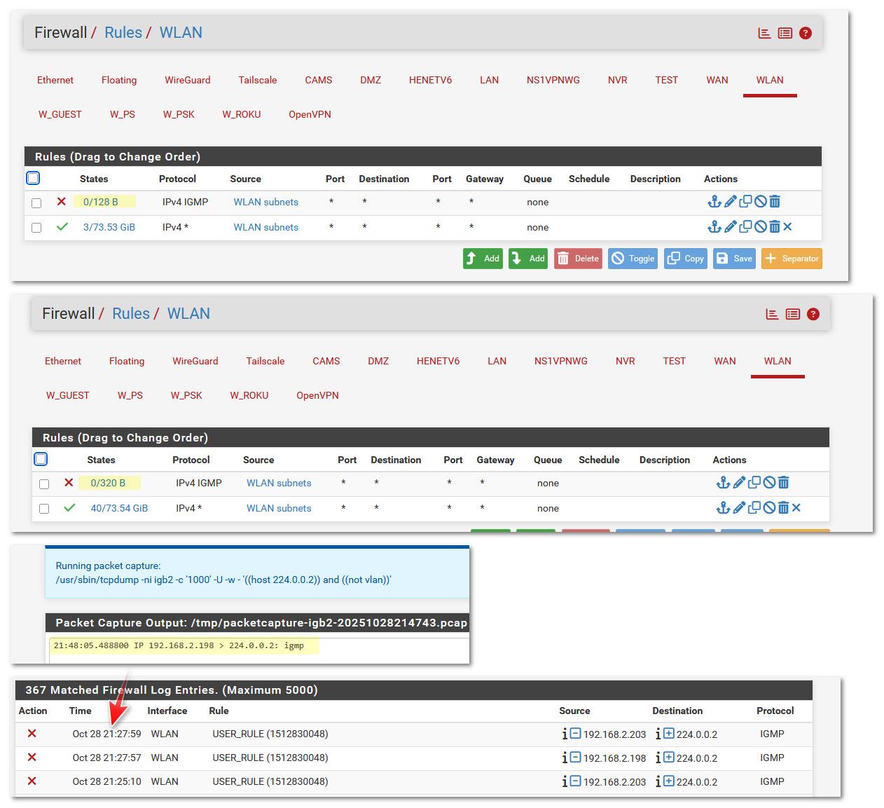

                                  • johnpozJ Online
                                    johnpoz LAYER 8 Global Moderator @Mission-Ghost
                                    @Mission-Ghost so I am not sure what you have going on.. But I found something (my iphone) that is sending out igmp on one of my wifi vlans its currently connected to.. It is sending it out every few minutes - I really hadn't noticed it before. So not sure if normally does it or not. But if you notice when I filter on igmp - there are some 378 log entries (all from my iphone 192.168.2.198) in the last 24 hours.
                                    I set it to normal block - because there is zero anything pfsense is going to do with traffic sent to 224.0.0.2 that is for sure.. I can play with setting it to allow later. But for now blocking it, clearly stops it from showing up in the logs.
                                    So you can see my default allow on my wlan was logging it, you can see previous logs going back to at least 21:23:15, and the last log entry at 21:27:59, you can see my new rules loaded at 21:30:26.. There are way more than that - but no reason to show huge list of the same thing.
                                    I no longer see any hits in the firewall for igmp.. And you can see my rule has triggered at least a couple of times via the states going up from 0/0. And you can see firewall is still seeing igmp traffic via packet capture I fired up - notice the time 21:48 in the packet capture.
                                    Its getting a bit late here, but tmrw if the phone is still sending it out, be happy to change that to an allow rule. But this is really how simple it should be to prevent logging of that noise, another option would be just to allow IP options on your allow rule that is currently blocking the traffic. I will fire up a test of that as well.
                                    You got something weird going on - you should never see traffic from one network(vlan) on a different interface other than that networks interface. So either you don't actually have isolation at layer 2, or you have something repeating the traffic into a different network/vlan.
                                    edit: btw this is the only thing that seems to send igmp in my whole network, at least in the last 24 hours that is the only IP see in my logs. Or as far back as 5000 entries go back. And I really don't do much logging, I only log syn hits to my wan, and some specific ports on udp, and some specific rules. As you can see I have many networks, and lots and lots of devices.. Just looked an there are 41 different wifi devices connect to multiple different vlans(ssids).. And quite a few wired devices as well, and also vms and dockers running connected via wire.. It seems insane to me you should see that much igmp traffic - unless you were specifically using it for something - my rokus sure don't send any of it out. Maybe its your hdhomerun thing? But again you should only see that on the network that device is actually one.. That you seeing that much seems to me you have some sort of loop or rebroadcaster that is putting that traffic out on multiple interfaces.
                                    edit2: before someone chimes in on my open rules on this wlan interface ;) This is my trusted wifi network, you have to have auth via wpa3 enterprise via eap-tls (so you have to have cert).. Only my phone and my tablet ever log into this network.

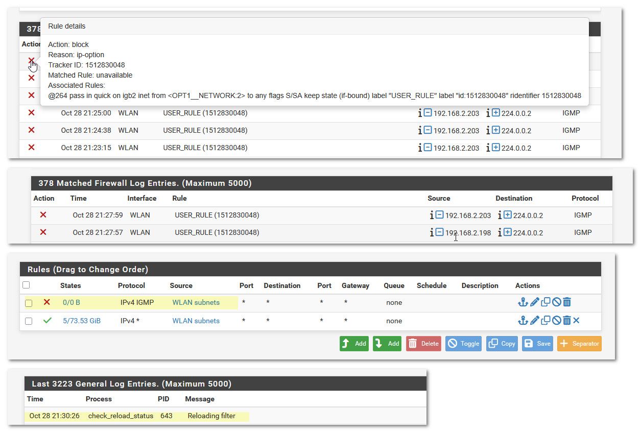

                                      Mission-Ghost @johnpoz
                                      @johnpoz thanks for the detailed post. It gave me a couple of ideas but it's getting late here too so I didn't do too much. It's a fascinating, if frustrating, problem.
                                      I created a blocking rule at the top of the 50 VLAN blocking IGMP with allow ip options to no effect. There are a few packets and kb showing up in the block rule but the logs keep coming from my pass rule. The pass rule is set to not log. I made sure all the pass rules in the 50 VLAN have allow ip options enabled, to no effect. The logs just keep coming.
                                      I tried a similar fast floating block rule on all VLAN interfaces to no effect.
                                      I unplugged the HDHomeRun box associated with all this starting (but not apparently causing it) to no effect.
                                      So I finally tried going nuclear and put a block any protocol, any source, any destination with allow ip options at the top of the 50 VLAN rule set and the logs keep coming. From the PASS rule at the bottom of the list! No effect.
                                      Theoretically, that block should block all 50 VLAN traffic. Full stop. Right? It shows zero states and a couple of kb.
                                      Something funky going on...
                                      I'll try reboot(s) again next chance I get, but that won't really diagnose what's going on even if it works.
