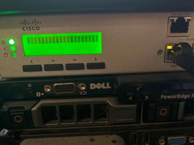

                    i finally found the time and did successfully install pfsense on cisco/meraki mx400. i could'nt get the video via vga as i am colorblind and can't tell the pinout.
                    i can't display on the front panel because i don't know the config for this unit. if anyone could help with the led panel config i would love it.
                    this was originally for the kid and his friends to do but they prefered roblox, hot wheels unleashed, or live home 3d.
                    thanks for identifying the manufacturer cause i some how found a manual that gave all the engineering for the mx400 (less the cisco butchering).
                    i love it
                    I 1 Reply Last reply Reply Quote 1
                    • I Offline
                      interrupt @interrupt
                      i have lcdproc configured and its fully functional. i will post a pic later.

                        interrupt
                        Re: Running pfSense on a meraki MX400

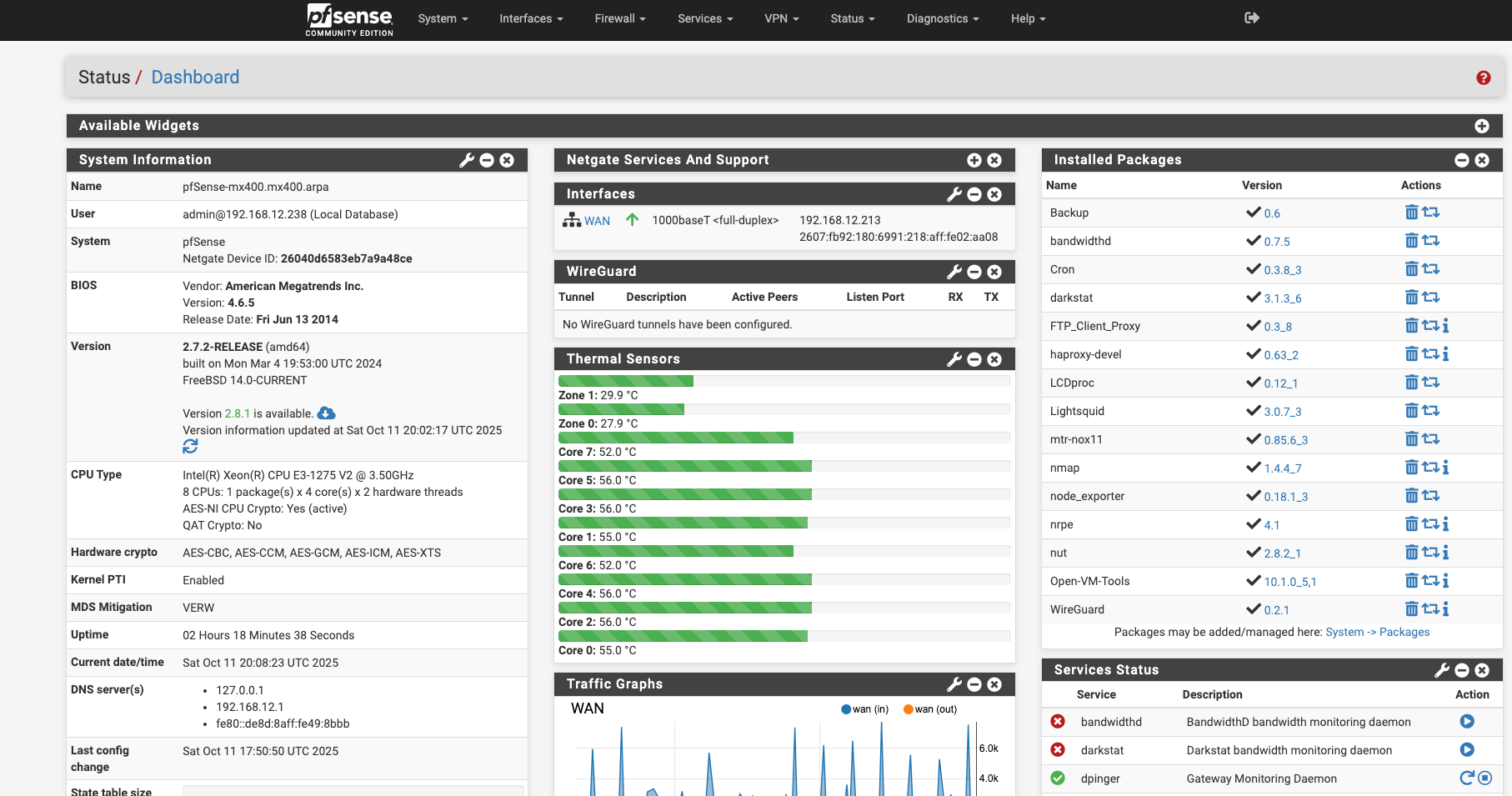

                          @interrupt said in Running pfSense on a meraki MX400:
                          Thank you in advance for that! Looking forward to it. If possible, could you also post a brief hardware overview (I can see from the screenshot that the processor is Xeon E3-1275 v2, but there no information about stock memory and storage) and Lanner motherboard model number?
