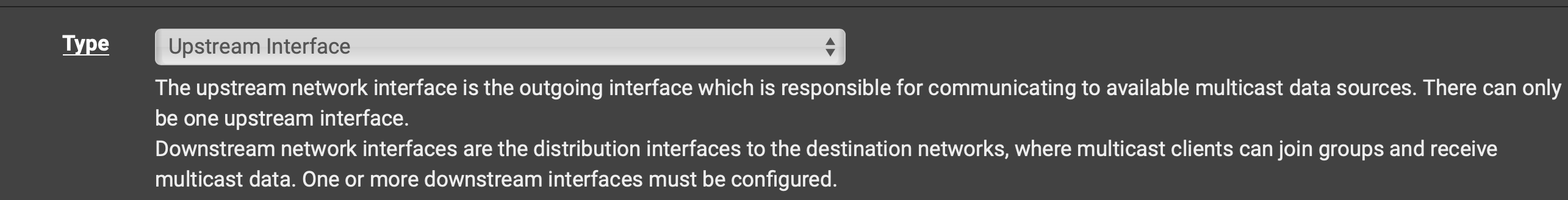

                When creating IGMP proxies, would the IOT network that has the speakers on it be Upstream or Downstream for type?
                I would intuitively selected downstream, but I see conflicting info about this too online.
                Thanks!

                      @johnpoz @stephenw10 that's what I thought, but pfSense has the following notice. If there can be only one upstream interface but you can have multiple downstream interfaces that would mean that you can only connect to the IOT network from a single interface which makes little sense.
                      What if I want to connect to the IOT network (to the speakers) from other networks?

                                @CharlesT so the speakers on the iot are the upstream.. But the speakers are not found via multicast they are found via mdns..
                                Well that works out for you then I would think you can talk to your speakers from multiple networks.
