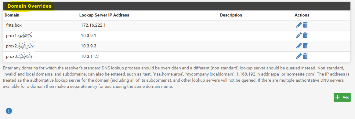

            @kevdog Maybe this helps.
            The IPs used are from WireGuard.

                @kevdog said in How to DNS resolve with Wireguard Site to Site VPN using two pfSense installations?:
                Ok thanks for picture, but I take it this domain override section is present on every host -- prox0, prox1 and prox2?
                Right. And the one where this picture is taken from.
                With this configuration, I'm still not sure how this helps solve the issue. If the remainder of the Domain Overrides section is different on prox0 as compared to prox1, how do LAN clients on the prox0 LAN query DNS domain overrides that are present on prox1?
                Are you really talking about Domain Overrides? For Host Overrides they only will be looked up if the domain part is matching with the Domain Override.

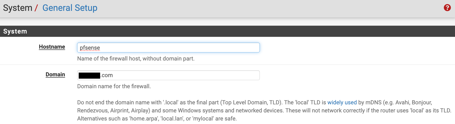

                  @Bob-Dig Ahh I think I became pigeon holed in my understanding -- Domain override -- not Host Override.
                  Ok I think I'm back on track a little. Just a few followup questions. I different (sub)dowmain, I take it that each site has a different domain specified here:
                  Screenshot 2024-07-10 at 7.01.56 AM.png.
                  When establishing the wireguard site to site connections - do you specify IP address or use domain names as the endpoint? I only ask this since my endpoints are setup using domain names rather than IP addresses. The domain names require an external DNS lookup via an external server to establish the IP address. I don't have a fixed IP address and although it doesn't change that option theoretically could change, hence using pfSense's dynamic DNS updater to update the DNS record at cloudflare.
