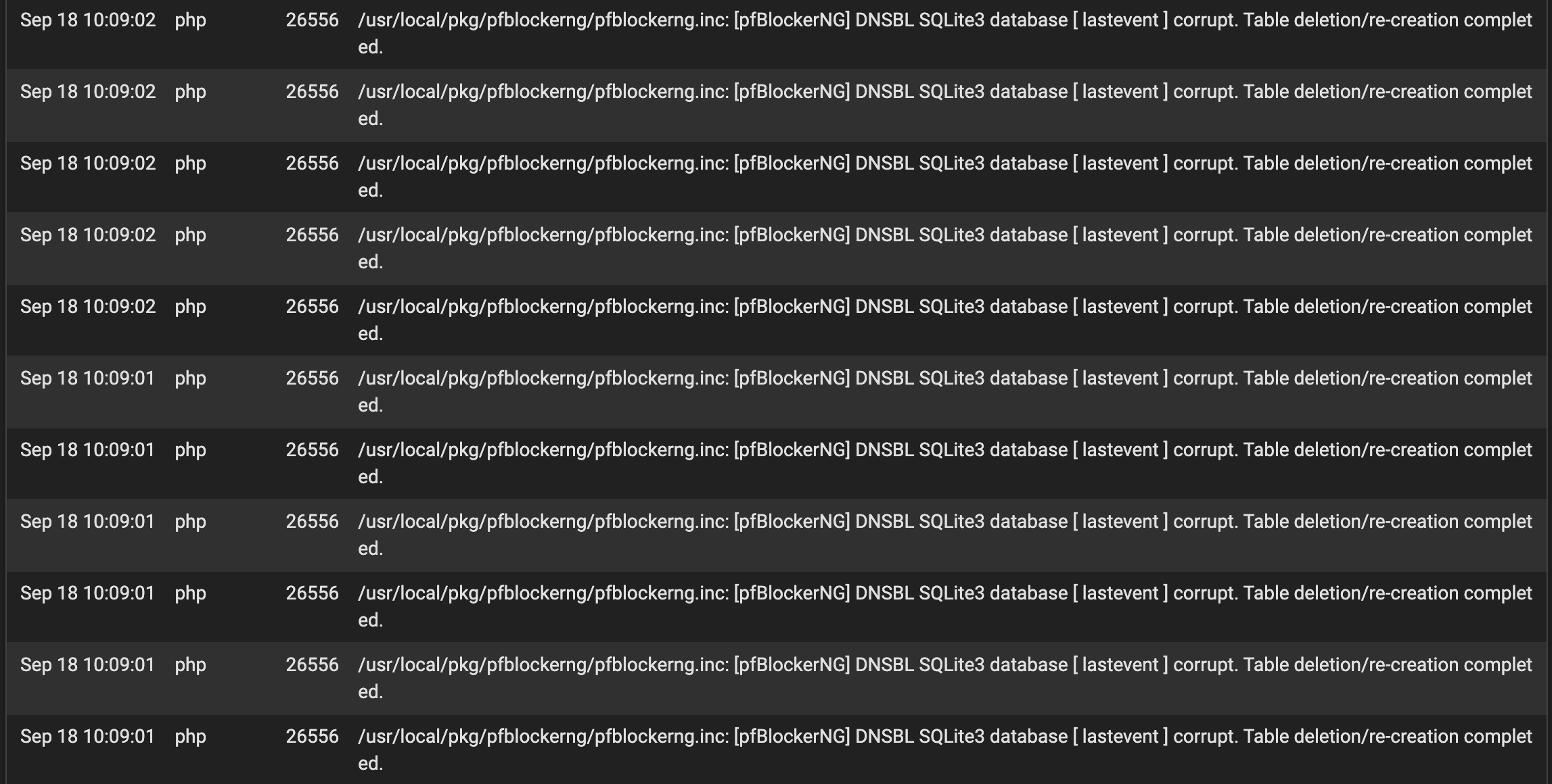

      I couldn't find a thread about this but recently I've been getting hundreds of these errors logged.
      I removed the package and re-installed but no change. I have re-booted the FW but no change.
      The system has been running for years and has been regularly updated without issues. Also pf-blocker seems to be running fine otherwise nothing in the pfblocker error logs. These only appear in system logs.
      Running
      2.7.2-RELEASE (amd64)
      pfblocker ng 3.2.0_8
      All recommended patches applied.
      Any idea what could be causing this?
      Thanks!

                                      restoring cache, number of entries in zone are generally not related.
                                      Cache works just fine... and any 2 hour sample here will run cache from about 35% to 60% cache hit depending who's doing what. The past 2 hours looks kind of like this.
                                        Gertjan @jrey
                                        @Klaus2314 said in DNSBL SQLite3 database [ lastevent ] corrupt messages in system logs:
                                        Certainly no 35 seconds..
                                        My pfb_py_zone.txt has 119 414 entries.
                                        Yours has 98 926 entries, somewhat less.
                                        before, you showed this :
                                        That's waaaay bigger. Like 68 Mbytes big.
                                        Your pfSEnse has probably bit more 'hose power' as mine.
                                        I've never really seen a benefit to "Resolver cache restored" that takes a lot of time.
                                        The unbound cache - there are command line commands to dump it - isn't that big.
                                        Its just useful to load it back in again. It's a cache after all.
                                        My cache : same info, shown differently :
                                        gray = served out of cache.
                                        Other colors : resolving was needed.
                                          jrey @Gertjan
                                          @Gertjan
                                          You're confused, that file size you are quoting back is from the OP not me.
                                          I was asking about your 35 second time from your system compared to my unbound and that section of the log where you show and calculate the 35 seconds.
                                          a) yes on my little test box the "list" is a little smaller (process time 2 seconds) I said that.
                                          b) I also said on my 2100 the list is a little larger than yours but the the timing of the unbound restart in that section of the log is similar to my little test box ~ 2-4 seconds
                                          The only difference I can see is that you are restoring the unbound cache, that is where the time difference appears to be from. And I went on to say that I've never seen a benefit to doing that and my cache hit rate is just fine.
                                          All I've said is I've never seen a benefit to restoring resolver cache...and therefore taking the time hit doing so. The cache works just fine here.
                                            Gertjan @jrey
                                            @jrey said in DNSBL SQLite3 database [ lastevent ] corrupt messages in system logs:
                                            You're confused,
                                            Noop. The @Klaus2314 didn't made into my post - I've edited.
