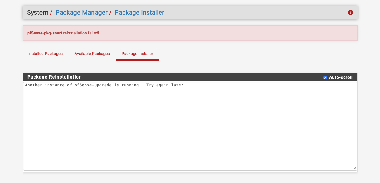

    @SteveITS I may yet have to do a full reinstall, I did a force reinstall of nut which pulled a newer version, so there is at least some package sync issues, and with it not being available in the package manager in the UI, I cant reinstall it the normal way. I assume I have somehow broken the package state, perhaps got away with it on other packages, but it seems critical on Nut. I just installed 'filer' from the UI, it installed with no error, and is in the menu, but even that hasnt appeared in installed packages. Ok Nut is on again now, is a second package. 'pkg-static install -yf pfSense-pkg-nut' https://forum.netgate.com/topic/102959/nut-package-2-8-0-and-below/15 I will raise this on pfblockerng github, previously all of my network upgrades of pfSense have gone perfect.

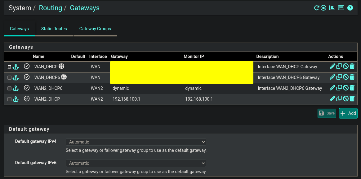

    That is probably the expected behaviour. If you have more than one IPv4 gateway assigned you should set the default gateway to something specific or a defined group. If it's set to automatic then the system will switch to the other gateway if the main WAN goes down at all. After that it will not switch back unless the other gateway goes down, but it's unlikely to since it's internal.

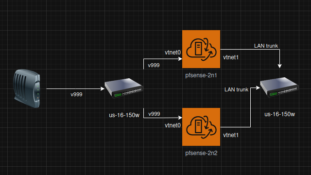

    What WAN type do you have? I would normally expect Unbound to work fine on both nodes all the time.
