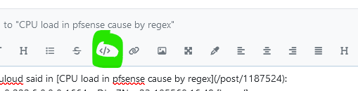

                                    Use :
                                    so things becomes way more readable :

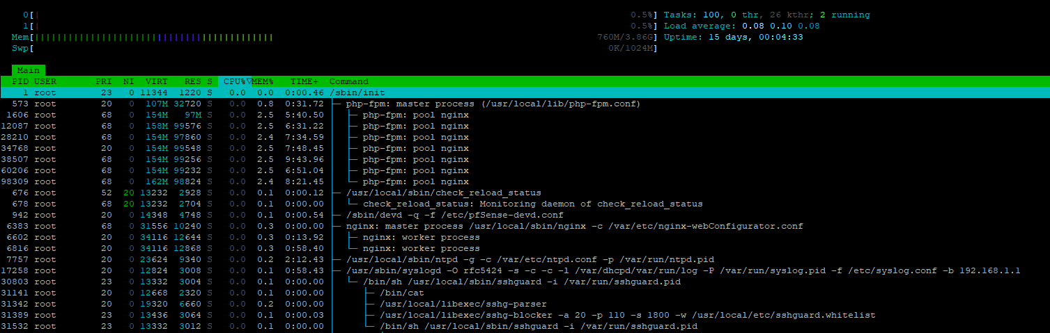

                                    [24.03-RELEASE][root@pfSense.bhf.tld]/root: ps -auxwwd
                                    USER      PID  %CPU %MEM    VSZ    RSS TT  STAT STARTED        TIME COMMAND
                                    root        0   0.0  0.0      0   1312  -  DLs  24Sep24   244:14.24 [kernel]
                                    root       11 198.9  0.0      0     32  -  RNL  24Sep24 41066:28.47 - [idle]
                                    root        1   0.0  0.0  11344   1220  -  ILs  24Sep24     0:00.46 - /sbin/init
                                    unbound 54544   0.4  3.8 185892 154088  -  Ss   00:15      12:40.44 |-- /usr/local/sbin/unbound -c /var/unbound/unbound.conf
                                    root      573   0.0  0.8 110112  32720  -  Ss   24Sep24     0:31.72 |-- php-fpm: master process (/usr/local/lib/php-fpm.conf) (php-fpm)
                                    root     1606   0.0  2.5 158668 100040  -  I    Tue08       5:40.50 | |-- php-fpm: pool nginx (php-fpm)
                                    root    12087   0.0  2.5 162764  99576  -  I    Mon13       6:31.22 | |-- php-fpm: pool nginx (php-fpm)
                                    root    28210   0.0  2.4 158668  97860  -  I    Mon12       7:34.59 | |-- php-fpm: pool nginx (php-fpm)
                                    root    34768   0.0  2.5 158668  99548  -  I    Mon12       7:48.36 | |-- php-fpm: pool nginx (php-fpm)
                                    root    38507   0.0  2.5 158668  99256  -  I    Mon08       9:43.96 | |-- php-fpm: pool nginx (php-fpm)
                                    root    60206   0.0  2.5 158604  99232  -  I    Mon13       6:51.04 | |-- php-fpm: pool nginx (php-fpm)
                                    root    98309   0.0  2.4 166860  98824  -  I    Mon09       8:21.45 | `-- php-fpm: pool nginx (php-fpm)
                                    root      676   0.0  0.1  13232   2928  -  INs  24Sep24     0:00.12 |-- /usr/local/sbin/check_reload_status
                                    edit : Ok, coll, you figured it out 👍
                                    or use top (install htop ^^) and I sorted on "CPU Load":
                                    edit : you have a "7100". That's not a small system.
