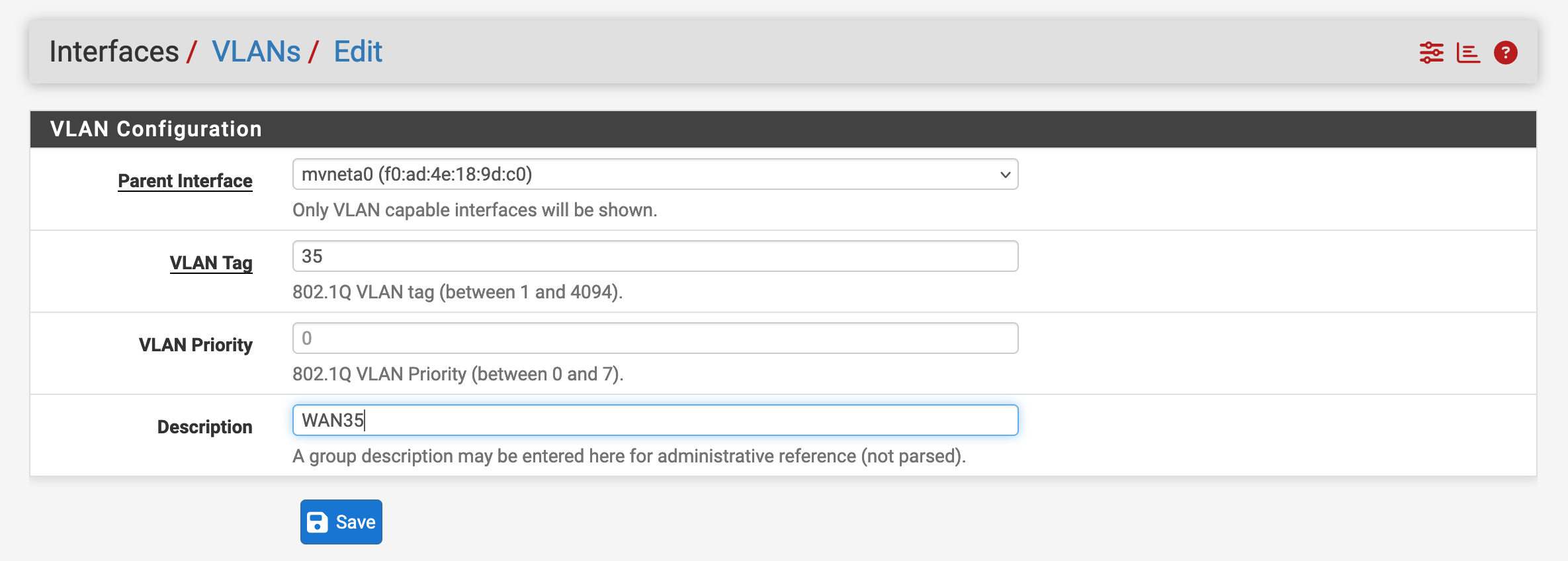

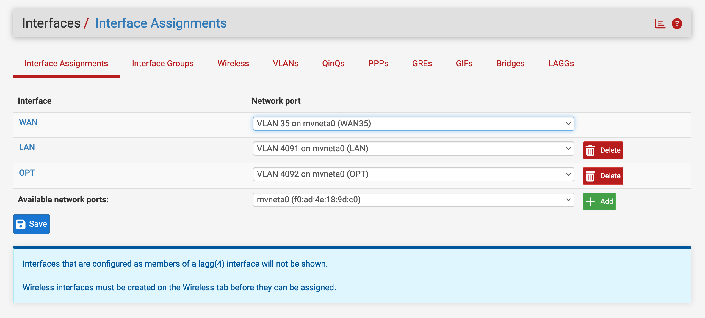

              Since the default WAN is tagged 4090 and my ISP seems to need 35 (see original ASUS parameters in first post), I tried to create a new VLAN and assign it to WAN.

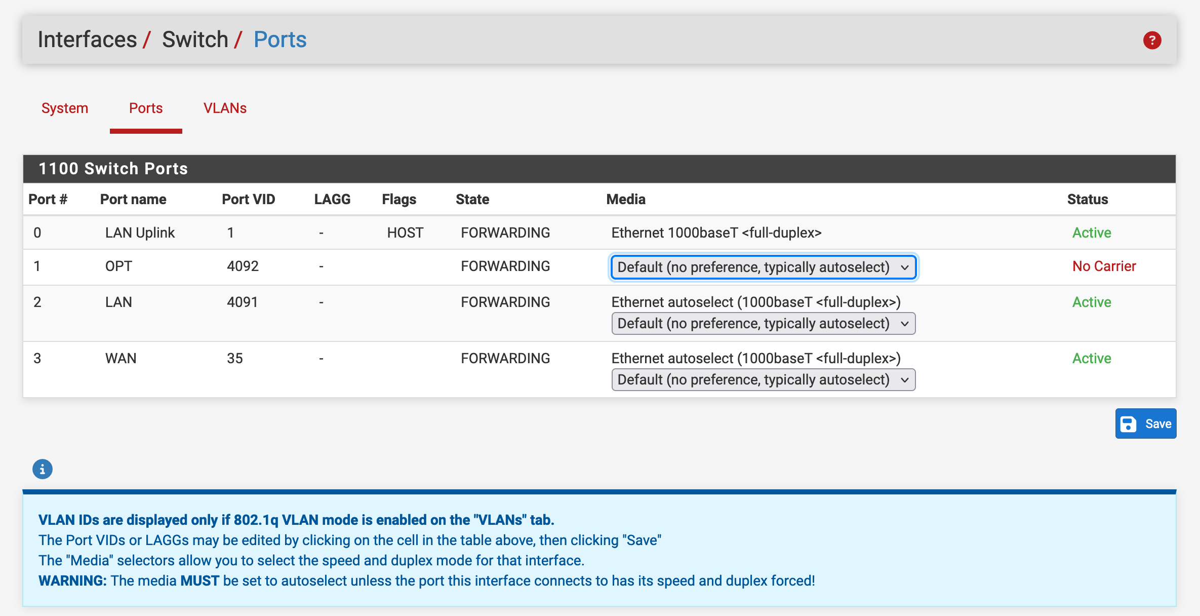

              I also tried to update the switch part
                Ok you need to pass that traffic tagged out out the WAN port. In the default setup the switch removes all the tags on traffic leaving the port.
                So in the Switch > VLANs config edit the WAN (35) and set port3 as tagged so it shows members: 0t,3t
                X 1 Reply Last reply Reply Quote 1
