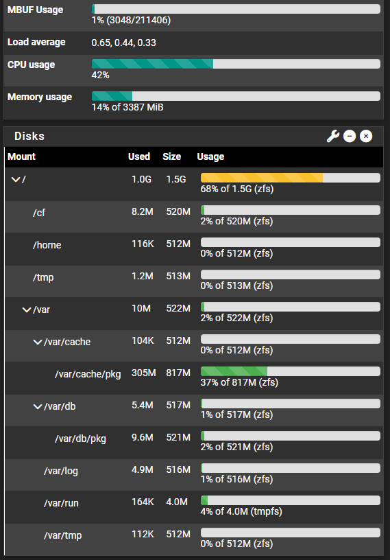

            Does it seem like its OK on disk space?:
            zfs list -t snapshot
            Thank you!
              SteveITS Galactic Empire @smk
              @smk Yes, the 2100 should have way more than 1.5 GB. Ignore the BE sizes and delete several/many of the oldest, see how much space you have.
              Upvote ๐Ÿ‘ helpful posts!
                Yup that^. 500MB free is not enough to run the upgrade. Remove old BE snaps.

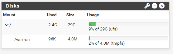

                    I tried to check what has been recommended in this thread but I am getting this message "This system does not support ZFS Boot Environments."\
                    Any advice ?
                    TIA.
                      Probably not running ZFS. In which case the drive is probably filled with something else. Usually logs from some rogue package.
                      The disks widget on the dashboard should show the filesystem type and the available space.
                        mhijazi @stephenw10
                        I checked but it does not seem that it is filled.
                          Hmm, then it should work. But you're not seeing a disk space error?
