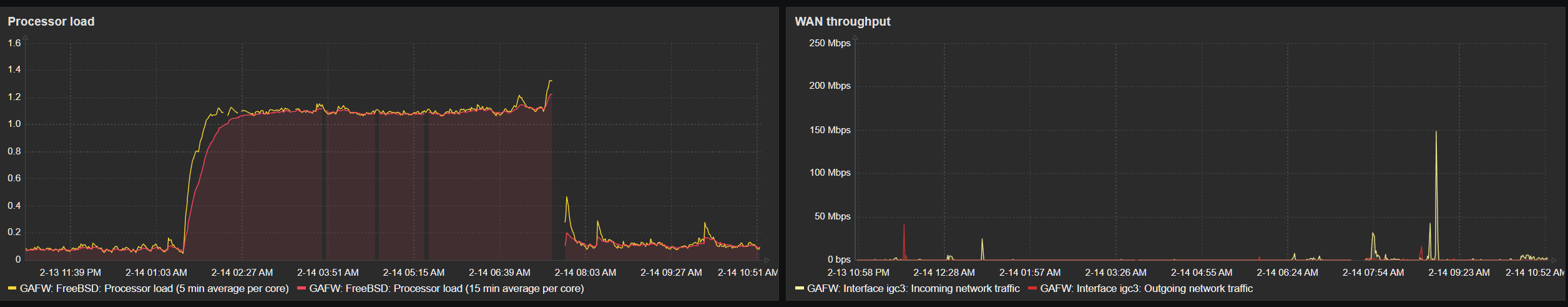

      Ive had very strange problems dealing with limiters in the past and the strangness continues. The symptoms I have after a configured Limiter and applied to a firewall rule is that after a few days or maybe a week, the Internet stops working. Further investigation shows that DNS stops working. Inter-vlan routing is still fine if i try to access resources using IP instead of DNS.
      Another symptom is during troubleshooting if i see what is taking up the most CPU resources its always 'if_io_tgg_2' which is traffic related. See below.
      Right away once i saw all of these issues i knew this was related to my Limiter i configured a week ago. So the first step is just delete the limiter. To my surprise.....The configuration is gone..

          When the limiter malfunctions and the network becomes unstable, CPU is through the roof.
          This is the exact same condition that happened last year when i was trying to troubleshoot this problem. I later figured out it was due to a configured limiter. Once I deleted it all my instability went away.
          Good thing i remembered because those symptoms are back...
