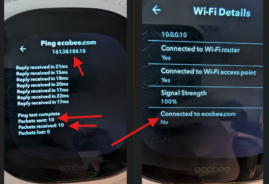

      Hmm, so previously when this happened you were only able to get it to reconnect by forcing a change in the WAN IP?
      There might be some clue if you were able to capture the traffic at the point it failed but that could be tough. It's unpredictable as I understand it.

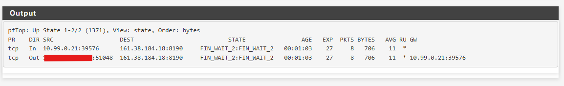

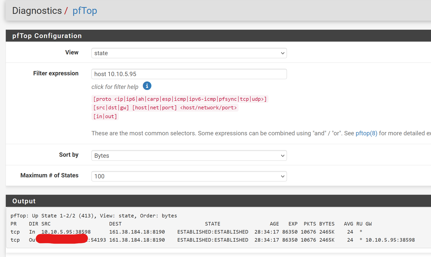

          @ezhawk Still think this is somehow a states problem.
          In pftop, I noticed this,
          Under exp, it resets to 86400 every 30-60s. It's almost as somehow this isn't working right on your end.

            and now...it has lost connection to the server again

              This is what I always see when behind pfSense.
                The state expiry time for a TCP established state is a lot longer than one in fin_wait. Since in the failure mode it never reaches established it expires and is recreated. But the pcap shows the server side sends the fin packe. Like it's just refusing the connection from that thermostat. Or that IP.

                                Ecobee behind pfSense doesn't work. No server connectivity. I spoof my WAN mac to get a new IP. Connection works for 1-14 days and then connection fails and it will never restore. We have done pcaps, both wan and lan side. When ecobee is connected to Cisco it will remain connected for MONTHS, no drops and no issues. put traffic back on the pfSense and will work for 1-14 days before dropping again and will NOT reconnect. I've gone through the mac spoofing no less than 6 times and it has behaved the same every single time. If it were the WAN IP getting black listed, explain why it only gets black listed when connected to pfSense and never gets black listed connected to Cisco?

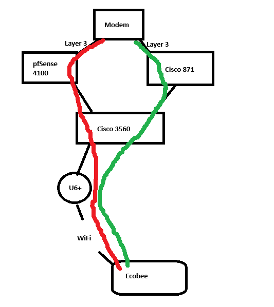

                                i only introduced the Cisco after having to do repeated IP changes on the pfSense to restore connectivity. so, instead of always changing IPs i stood up a second egress device to specifically send the ecobee traffic around the pfSense so I can keep connection working. I also did it as a PoC to show the pfSense is the source of the problem.

                                    This is exactly what I have. I have the Cisco and pfSense both up. Right now, I send traffic to Cisco everything works no issues, I send traffic to pfSense and it is failure. I have a very defined situation that is repeatable and illustrates the issues.

                                        @ezhawk Might help to identify what the Cisco router is?

                                        For those of us here it would also help to have a clear topology of your network hardware. From the above, im not clear if pfsense is out of the loop entirely when the cisco device is present.

                                          Really simple but this is Topo. I have to reboot the Ecobee to get it to switch paths. Same internal subnet, but I use a different default gateway for the IP on the Cisco to send traffic out via the Cisco. All my network traffic other than the Ecobee goes through pfSense and I don't have any issues with anything.
                                          Both Layer 3's links are Layer 3 on the pfSense and Cisco, so it isn't something like a loop taking place. The Cisco was only added after months of trying to figure out why the pfSense is blocking.

                                            @ezhawk so where you say "modem" you actually mean gateway.. Because if that was an actual modem.. Traffic out of pfsense to the internet would have a different public IP then traffic flowing through the cisco.
                                            Either your natting these connections at your "modem" (so its not a modem) so you only have 1 public IP seen by the internet or your isp is providing you with multiple public IPs.
