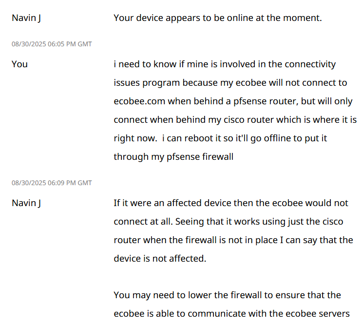

            out of curiosity have you checked with ecobee ?
            "ecobee has determined that a very small percentage of Smart Thermostats may experience difficulty connecting to our servers, leading to disconnection issues. If your thermostat has exhibited this problem, please use the serial number checker below to see if your device qualifies for our Connectivity Support Program."
            maybe you have and I just missed the reference or mention in this thread
            here is the link to check your serial number
            https://support.ecobee.com/s/esp/smart-thermostat-connectivity-issues
            E 1 Reply Last reply Reply Quote 1
            • E Offline
              ezhawk @jrey
              @jrey said in Ecobee thermostat can’t connect to servers:
              That's no longer a thing anymore according to Ecobee.

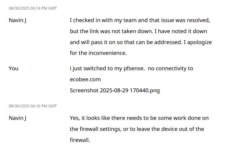

              And to no one's surprise, Ecobee says it is a problem with the pfSense since everything works fine when the pfSense is bypassed. They could see everything just fine until the pfSense was put in line.
                Just to be clear (and I leave it after that), my suggestion to contact support was not to blame them but get help from them, getting information about connection made by pfSense and if Ecobee was blocking that connection at some point. I suspect you won't get that info in a chat from a 1st level support.
