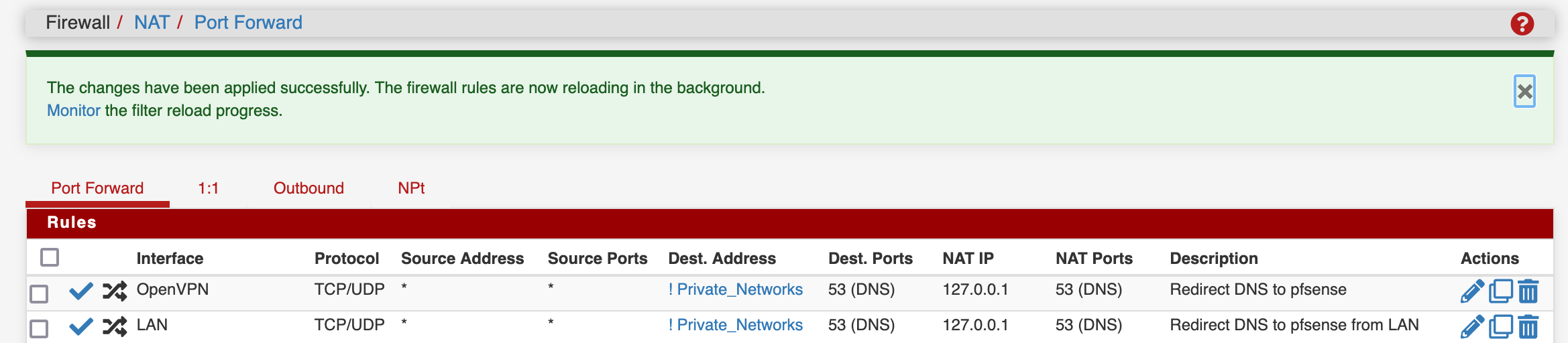

                @viragomann I'tried to set up this rule. First defines the alias private_networks.
                I wasn't succesfull....DNS requests havn't been redirected.
                I wasn't able to finde the menu that you have screenshot. It is not below firewall/rules or firewall/nat.
                Attached is the screenshot of my two nat rules.

                  Yes, it's a port forwarding rule, as mentioned. "Internal" is an interface group in my configuration.
