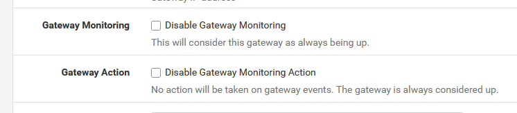

                          If you suspect that some one or some thing is playing with your ICMP packets, consider disabling the gateway action or even the monitoring. This can have also consequences of course.
                          Or change the settings, making it more 'patient' before it pulls the plug.
