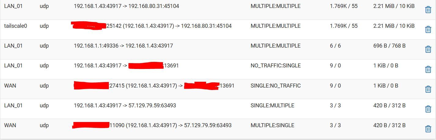

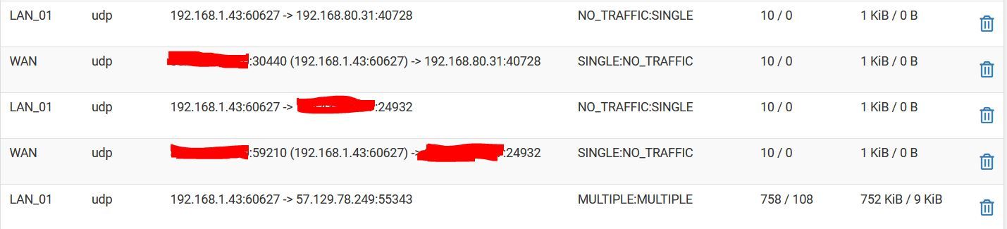

When Tailscale is up devices still can ping, connect from site A to B and vice versa but I cannot get the video stream from cam. It tries to connect and get stream for awhile and then gives error.Below are screenshots of pfsense states on site B filtered with cam IP (192.168.1.43) with Tailscale up and down.

with Tailscale up
with Tailscale down
