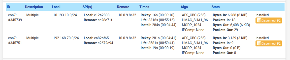

                      I created the second phase 2, it appears up in the dashboard, but it does not appear listed in ipsec > status
                      73be116c-9a8e-4b5e-8abe-dfe7aac7fed2-Captura de tela de 2025-05-07 20-42-14.png
                      file:///home/caiochagas/Imagens/Capturas%20de%20tela/Captura%20de%20tela%20de%202025-05-07%2020-42-14.png
                      7a5fb81d-b8cc-435e-8e60-77060bfe96db-Captura de tela de 2025-05-07 20-43-23.png file:///home/caiochagas/Imagens/Capturas%20de%20tela/Captura%20de%20tela%20de%202025-05-07%2020-43-23.png
