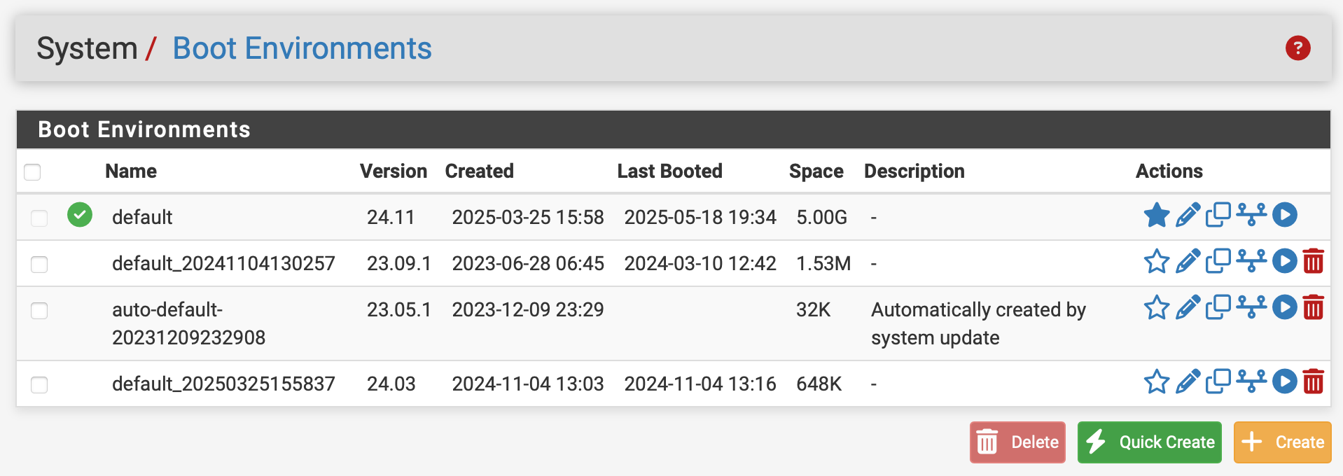

          Has that 2100 been continually updated from some much older version?
          Here is the Boot Environments view:
          The unit was purchased and installed oct 2023, config loaded from previous SG-1100 and adapted to SG-2100 switch configuration. The list appears consistent with my own change log, so yes it has been continally updated.
          Would you recommend a complete reinstall, just to be safe? Or stay put for now and upgrade to 25.03 when the time comes and check if the issue will have been self corrected?

            It won't be a problem before 25.03 for sure so I'd wait for that and see what the status is then.
            It doesn't hurt to reinstall though if you're able to do that.

              @Cabledude consider deleting old BEs you don’t need: https://docs.netgate.com/pfsense/en/latest/troubleshooting/filesystem-shrink.html
              Upvote 👍 helpful posts!
                Yes. Though on the MAX it's unlikely you're anywhere near filling the drive.
