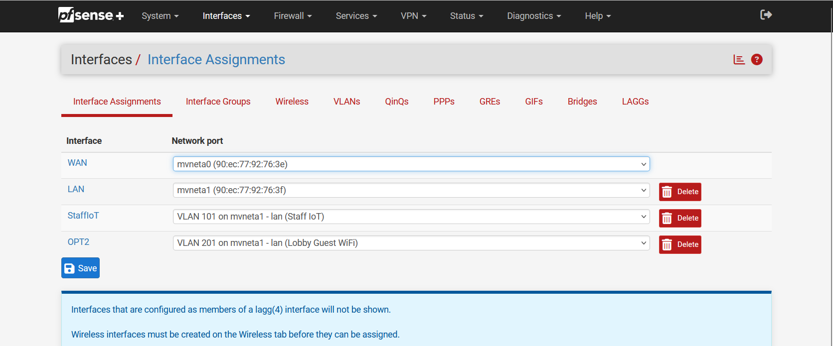

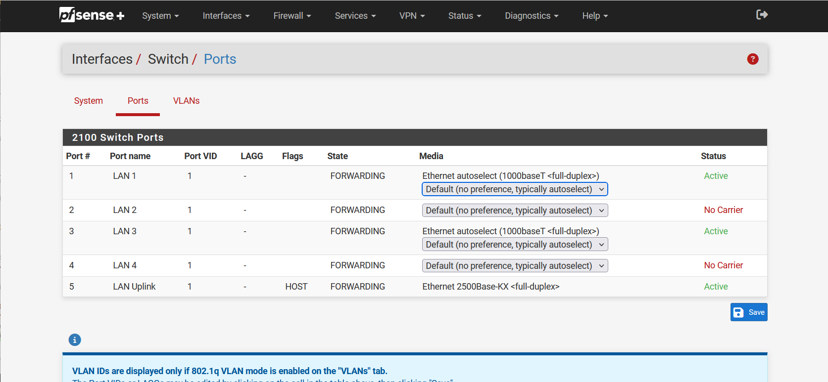

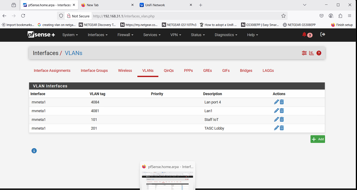

          Thanks for the response. I've done this with no success pulling the VLANS through. Here are 4 screenshots of PfSense VLAN config.
          Maybe you can see where I messed up?

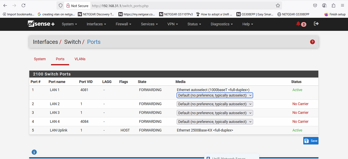

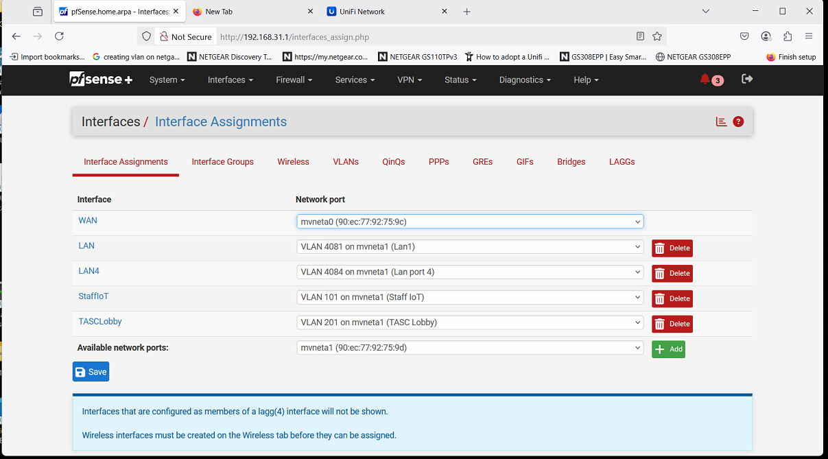

                @b3rt 1-Switch_Ports.png 2-Switch-VLAN.png 3-interface-assignments.png 4-interface-VLAN.png
                Thanks for the suggestions.... No VLAN works. went back to my fresh Unifi AP-lite connected to TP-Link SG108E, connecting to Netgate SG4860. as fresh install with all components fresh "factory-restore". Did fresh config with two VLAN and works fine.
                Did same test on a Proctli FW-2B vault,,, VLANs work fine.
                Returned to configuring to my new SG2100 Netgate... no VLAN works. It must be something simple I'm not seeing. Could someone show me your config for 1 or 2 VLANS?
                Failed to mention.... on the TP-Link switch... Port1 = Unifi AP (VLANS 101; 201); Port 8 = uplink to Netgate switch port 1
                Thanks for your patience.

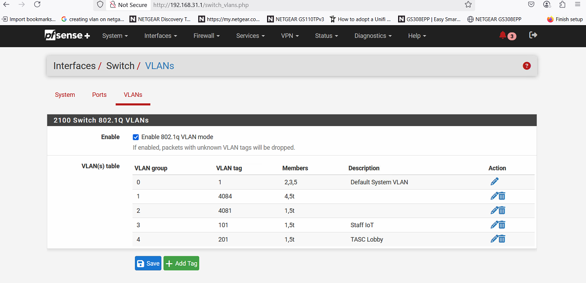

                  patient0 @detox
                  @detox one observation: In Interfaces / Switch / VLANs you have multiple VLAN groups (2,3 and 4) where port 1 is an untagged (native) member of. That can't be, one port can only have one native/access VLAN, the other VLANs have to be tagged.
                  For example:
                  • VLAN group 2, VLAN tag 4081, members: 1,5t
                  • VLAN group 3, VLAN tag 101, members: 1t,5t
                  • VLAN gropu 4, VLAN tag 201, members, 1t,5t
                  In that example configuration port one's native (Unifi naming, 'access port' in Cisco naming) is 4081 and VLAN 101 and VLAN 201 are tagged on port 1, making port 1 a trunk port.
                    What you were doing initially should have worked. VLANs 101 and 201 were trunked out of port1. As long as the Netgear switch was configured to handle those VLANs and was connected to port 1 it should have worked.

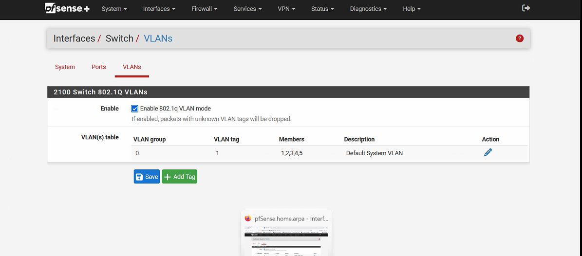

                          No you don't need to add anything when you enable dot1q mode. It sets the switch VLAN aware but passes untagged to all ports by default.
                          D 2 Replies Last reply Reply Quote 0

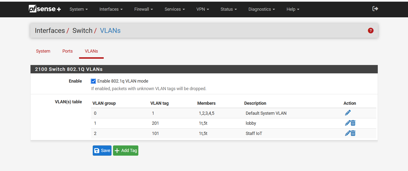

                            OK reset to default. first thing I did was flip the switch for 802.1q.
                            So my next step is to +Add Tag
                            VLAN tag = 101
                            Description = Staff IoT
                            Members = 1t (switch port on Netgate) and 5t (LAN Uplink)

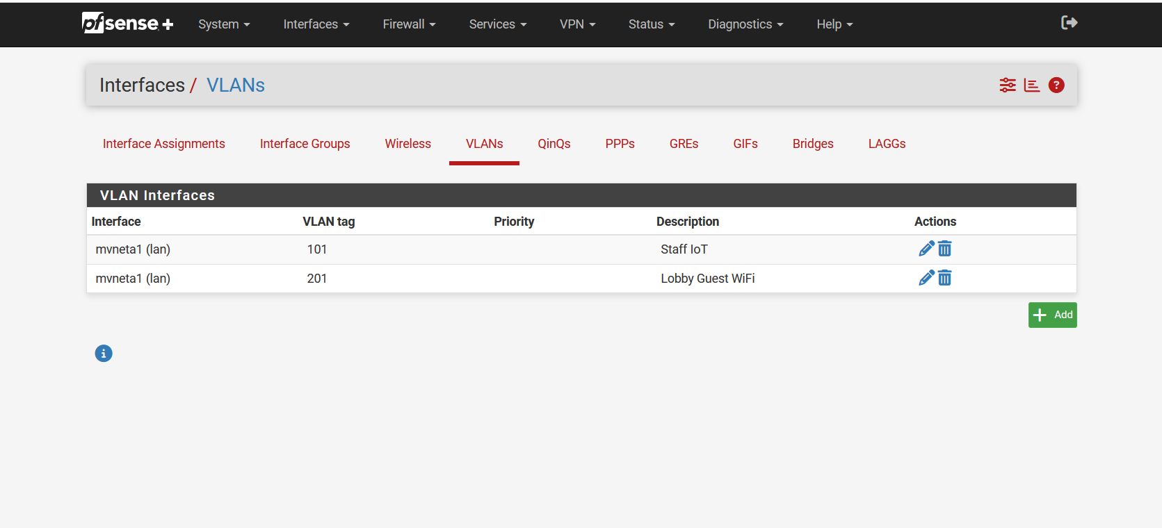

                            THEN... got Interfaces / assignments / VLANS
                            create VLAN101 as normal
                            Back to Interface assignment page,,, select VLANS.. enable on port (lan) 1 mvneta1
                            Sorry for the repetition,,,, hoping this works but if not, someone may see my mistake
                            and.... I do not touch settings on VLAN 1 correct?
                              detox @stephenw10
                              @stephenw10 I think it is time for a Happy Dance!
                              Do not know what I did differently, but, under you sage wisdom and tutelage, it is working!!!
                              Now I will save config and start on firewall rules.

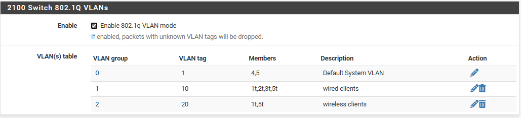

                                  @b3rt Re-reading your responses and saw the ports being used in the photo... just wanted to confirm what I am seeing..............
                                  VLAN 20 = ports used are 1 and 5, both tagged,, maybe port 1 is AP and port 5 is uplink?
                                  VLAN 10 = ports 1;2;3;5 all tagged using static IP? maybe printer, NAS etc? port 5 is uplink?
                                  VLAN 1 = ports 4, 5 port 4 for maintenance laptop and 5 uplink?
                                  If I am correct, then this shows I can remove all ports on Native VLAN except for uplink / Trunk (port 5)?
