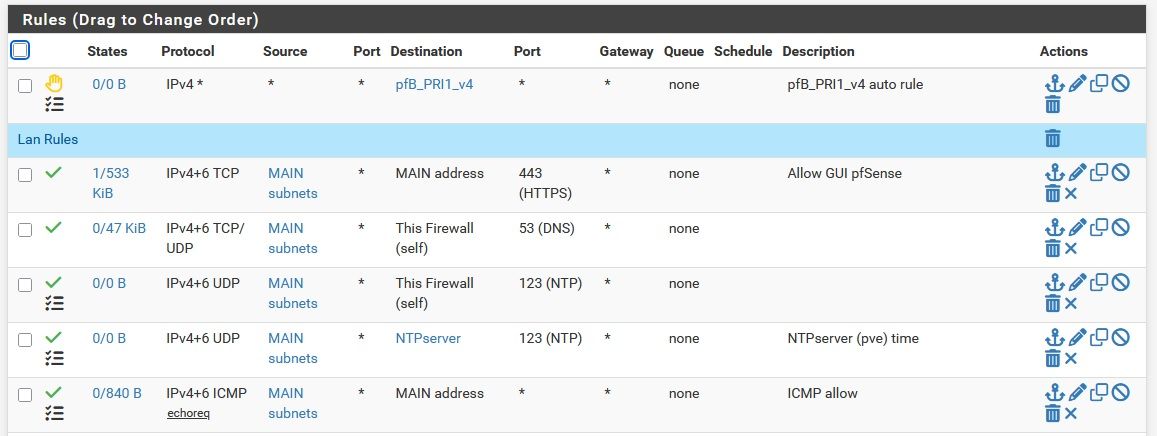

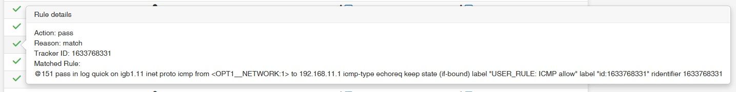

      • In pfsense Enabling "Log packet" on the pass ICMP rule -> shows ICMP from Proxmox (192.168.11.50) is passed when I attempt to ping pfsense (192.168.11.1)

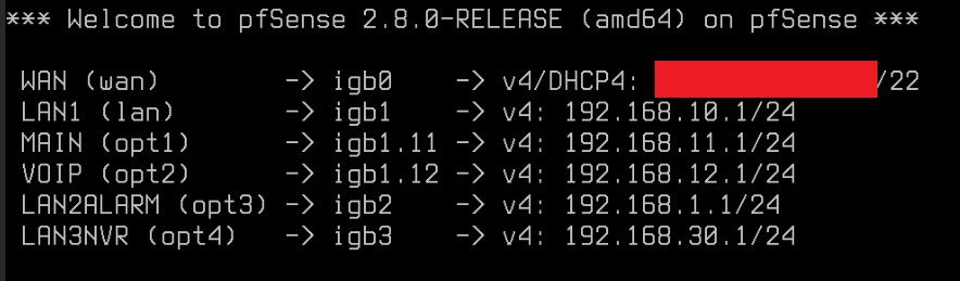

      • pfsense actually runs on a Proxmox VM with all NIC passed through. Proxmox runs on a MiniPC with 6 NIC (Intel i201/i211). As a result the data path failing is Proxmox Hypervisor (192.168.11.50 -> Linux Bridge -> Intel NIC on MiniPC -> Netgear JGS524PE programmable switch untagged VLAN 11 Port to trunk port -> Intel NIC on miniPC passed through to pfsense LAN NIC / VLAN 11 = OPT1 (Main)

              Are those rules in your screenshot floating or applied to an interface group? I agree the interface state policy change seems more likely here.
                Rules shown are for the interface Main (opt1) -> igb1.11 -> v4: 192.168.11.1/24
                The only Floating rule is disabled.

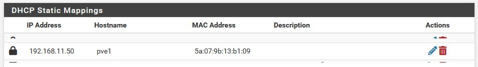

                    pfsense -> Services -> DHCP Server -> Main (which is on igb1.11) -> includes

                      Ah, you have added the static DHCP entry as static ARP also?
                      That's almost always a bad idea IMO! But if that MAC address is correct then it's not the cause of the problem here.
                      If you run a ping from proxmox to pfSense what states are created in the pfSense state table?
                      Try running a pcap in pfSense for that. Is the source MAC what you expect it to be?
                        Mmm, so there is a better way I have missed.
                        What is the recommended way of setting client computers IP address from pfsense?
                        @stephenw10 said in Update 2.7.2 to 2.8.0. Single compter lost pfsense connection:
                        Oops Bingo
                        Looks like I had an old incorrect MAC.
                        Proxmox GUI requires a static IP so two MAC addresses for one IP is not good.
                        Updated the MAC in pfsense DHCP rectified the communication fault.
                        Thank you for your help in correcting my error.
                          You can set a static DHCP lease but not set static ARP. Normally pfSense would just ARP for the IP and update the MAC in the table but if you mark it static things like this can happen. ๐Ÿ˜‰
