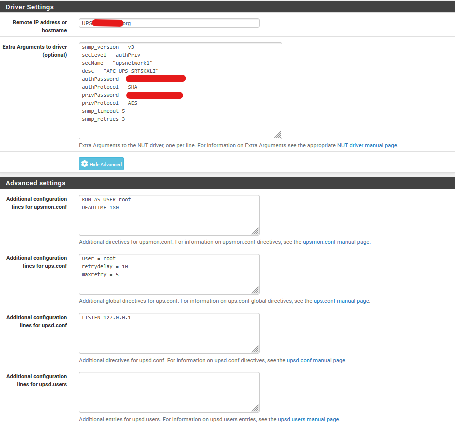

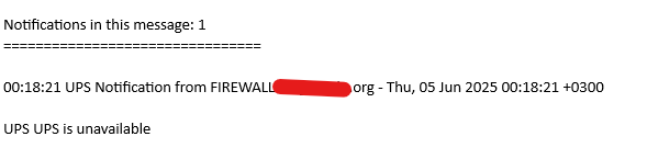

      This has been going on for a long time but just yesterday my mailbox filled with notification mails (more than 300 mails, it sent notification mails every 5 minutes) from pfsense saying UPS not available.
      The problem was UPS had no problem and was available but pfSense could not establish the connection with UPS. After a simple restart of the NUT service, and it was back online again.
      My UPS is APC Smart-UPS SRT 5000VA 230V SRT5KXLI with NMC3 built-in network card.
      UPS NUT settings
      What could be the problem here?
      Maybe DNS? or SNMPv3 problem? Some weird quirk of APC SNMP implementation?

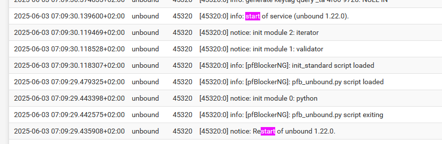

              Gertjan @Laxarus
              @Laxarus said in SNMP UPS inconsistent connection:
              DNS failure is one of the suspects
              No need to keep the "suspect" waiting, as you can consult the proof right away.
              Go here : Status > System Logs > System > DNS Resolver and see if you can find :
              If you find them, match the related time stamp info with the NUT UPS events (main system log).
              If they match, and it happens to often, get yourself this mission :
              Figure out why unbound restarts, then evaluate the conditions that made it restart.
              The final goal is (always) : make DNS as accessible as possible.
              For example : a default, "clean" pfSense install won't restart unbound for days, even weeks.
              Start plugging in and moving network cables into pfSense, or power down and power up devices attached to pfSense directly by cable, and every time packages get restarted.
              Install pfBlockerng and according its settings it can restart unbound many time per day.
              Depending how you use pfSense, what you've installed extra can make live hard for your DNS ... for yourself.
              Your mission as an admin : find the right balance.
