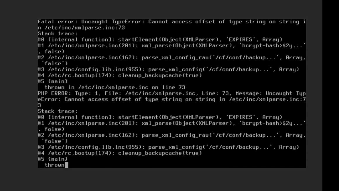

      After a power failure, and pfsense reboot, PPPOE, DHCP server, SSh , WEBGUI nothin working.
      also try restore backups, but no luck

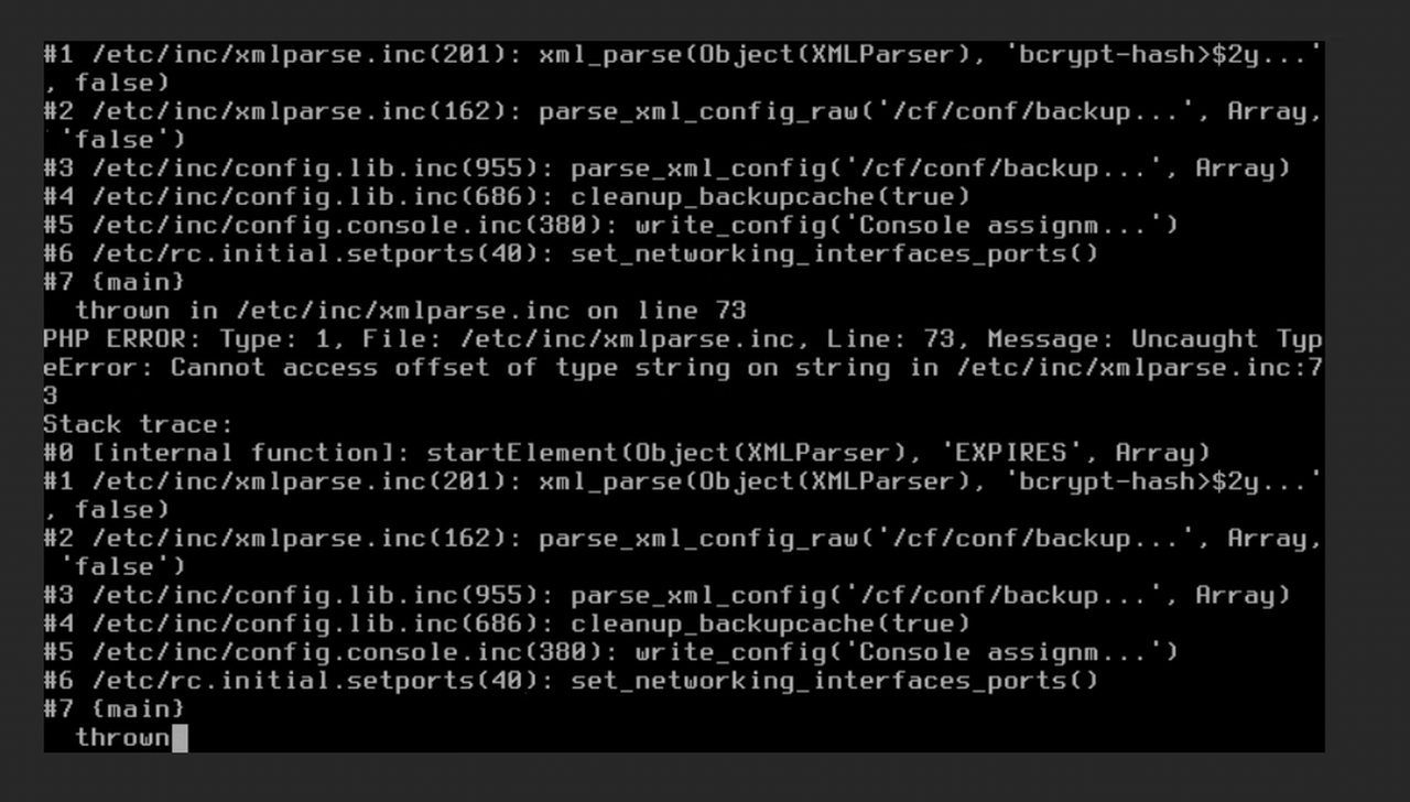

      and when i try to configure interfaces, it shows the following errors in the console:
      alt text
      'bcrgpt-hash>$2y.
      #1 /etc/inc/xnlparse. inc(2B1): xnl_parse(Object(XMLParser),
      false)
      #2 /etc/inc/xnlparse. inc(162): parse_xnl_config_rau( /cf/conf/backup...
      • false')
      #3 /etc/inc/config. lib. inc(955): parse_xnl_config( /cf/conf/backup... • ,
      #4 /etc/inc/config. lib. inc(686): cleanup_backupcache(true)
      #5 /etc/inc/config.console. inc(38B): 'Console assignn... • )
      #6 /etc/rc. initial . setports(4B): set _ networking _
      #7 {nain)
      thrown in /etc/inc/xnlparse. inc on line 73
      Array ,
      Rrrau)
      PHP ERROR: Type: 1, File: /etc/inc/xnlparse. inc. Line: 73, Message: Uncaught Tup
      eError: Cannot access offset of type string on string in /etc/inc/xnlparse. inc : 7
      Stack trace:
      'EXPIRES',
      [internal function]: startElement(Object(XHLParser),
      Array)
      'bcrupt-hash>$2g.
      #1 /etc/inc/xnlparse. inc(2B1): xnl_parse(Object(XHLParser),
      false)
      #2 /etc/inc/xnlparse. inc(162): /cf/conf/backup...
      'false')
      #5 /etc/inc/config . console. inc(38B): urite_config( 'Console assignn... • )
      #7 {main)
      throunl
      Array,
      Rrrau)

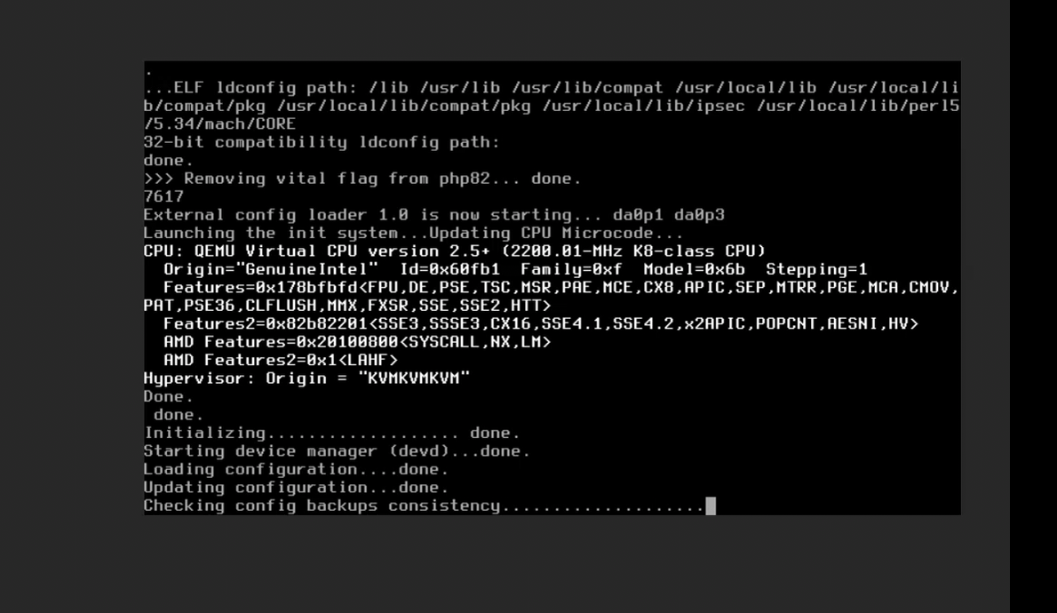

        @itsmejomijohn are there any errors after the boot menu, early in the booting process? And what is the device it is running on and the filesystem (UFS or ZFS)?
        • I Offline
          itsmejomijohn @patient0

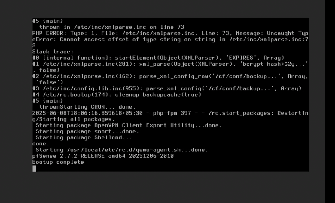

          @patient0 its running on Proxmox, the disk format is RAW, and the file system is ZFS.
          Here I am attaching the screenshots of the booting screen.
          alt text
          alt text
          alt text

            @patient0 the same error is showing for Restore last backup option and also when i try to assign ip address to interfaces
